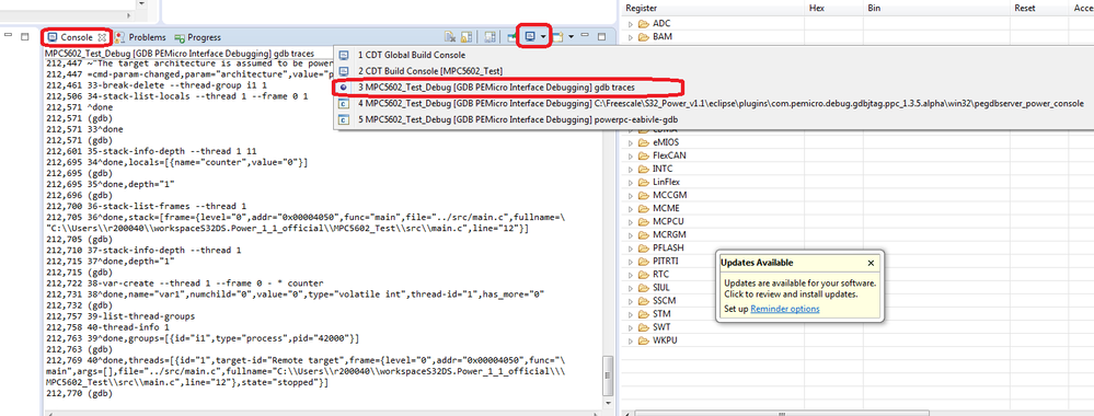

Can you please attach the snapshot of the error you get (including details)?
Also the debugger log might help us to find the root cause.
To get the log please switch the console to GDB Traces (see below), copy and paste the log into a file and post it here.
Thank you!
