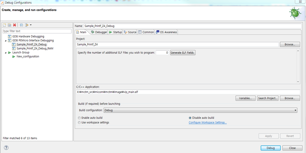

The project is based on GHS and I want to just flash this board using multilink and S32.
Following is my step.
1) create a new project.
2) connect elf file in debugging dialog like below.

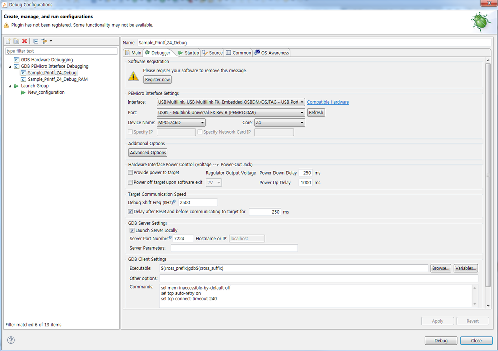

3) delay configuration like below.

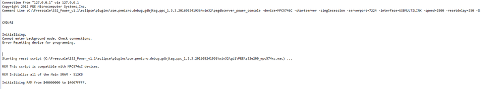

Connection from "127.0.0.1" via 127.0.0.1
Copyright 2012 P&E Microcomputer Systems,Inc.
Command Line :C:\Freescale\S32_Power_v1.1\eclipse\plugins\com.pemicro.debug.gdbjtag.ppc_1.3.3.201605241936\win32\pegdbserver_power_console -device=MPC5746C -startserver -singlesession -serverport=7224 -interface=USBMULTILINK -speed=2500 -resetdelay=250 -
CMD>RE
Initializing.
Cannot enter background mode. Check connections.
Error Resetting device for programming.
Starting reset script (C:\Freescale\S32_Power_v1.1\eclipse\plugins\com.pemicro.debug.gdbjtag.ppc_1.3.3.201605241936\win32\gdi\P&E\s32e200_mpc574xc.mac) ...
REM This script is compatible with MPC574xC devices.
REM Initialize all of the Main SRAM - 512KB
Initializing RAM from $40000000 to $4007FFFF.
Please give some feedback to resolve this issue.

1) Could you please create new project in S32 Design Studio and try to load the code from new project to your microcontroller? This could tell us, if the hardware is OK.
2) If you are able to load project from S32DS to microcontroller, please look at the following document. It seems your steps are very similar to steps described in the document, but could you please try it once again according the document?
https://community.nxp.com/docs/DOC-332252
Please let me know, if it works.
