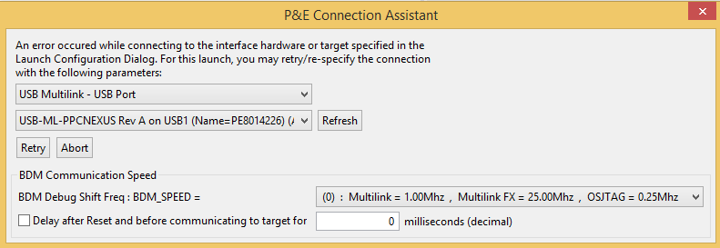

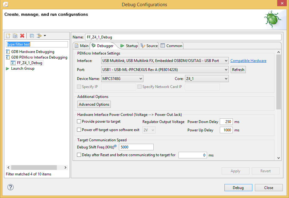

I tried to debug MPC5748G with P&E Multilink PPCNexus (Rev. A) using S32 Design Studio for Power. An error occured while connecting to the interface hardware. These are my Debug Configurations Settings:
And this is the P&E Connection Assistant Error:
I have no idea how to fix the issue and what is the problem?  Is there any other configuration should be modified for MPC5748G.

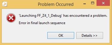

If i hit abort button another error appear at 95%:

Could you try to add e.g. 250ms delay after reset in the debug configuration dialog? We've observed that it's not possible to connect on some EVB revisions using default settings.

I tried to connect using PE micro and it works correct to me. Please clarify following points:
1) Check led diode D1. If this LED is ON, you may have incorrectly connected JTAG. Incorrectly connected JTAG connector may cause this issue.
2) Do you use mask 1N81M?

I checked led diode D1. Yes, it was ON. I installed a new driver version for P&E Multilink NEXUS and reconnected the MPC5748G-324DS Daughther Card and it seems that the issue is solved. LED is OF now and the error no longer appears.
