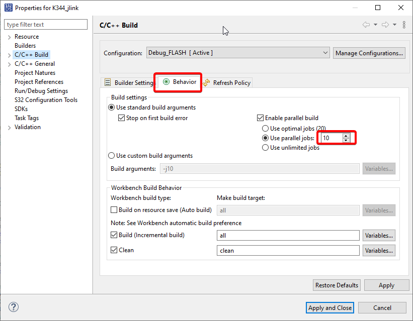

There is a probability that when using version 3.5 of S32DS software to compile the program, it will cause Microsoft system to get stuck. Only by forcibly power-off and restarting the computer can work again. Several people have already reported that this has happened.

try to decrease number of parallel jobs in project properties:

I tried for a few days, there was no computer stuck. The number of parallel jobs was set to 20.

Thank you. I'll try for a while.
