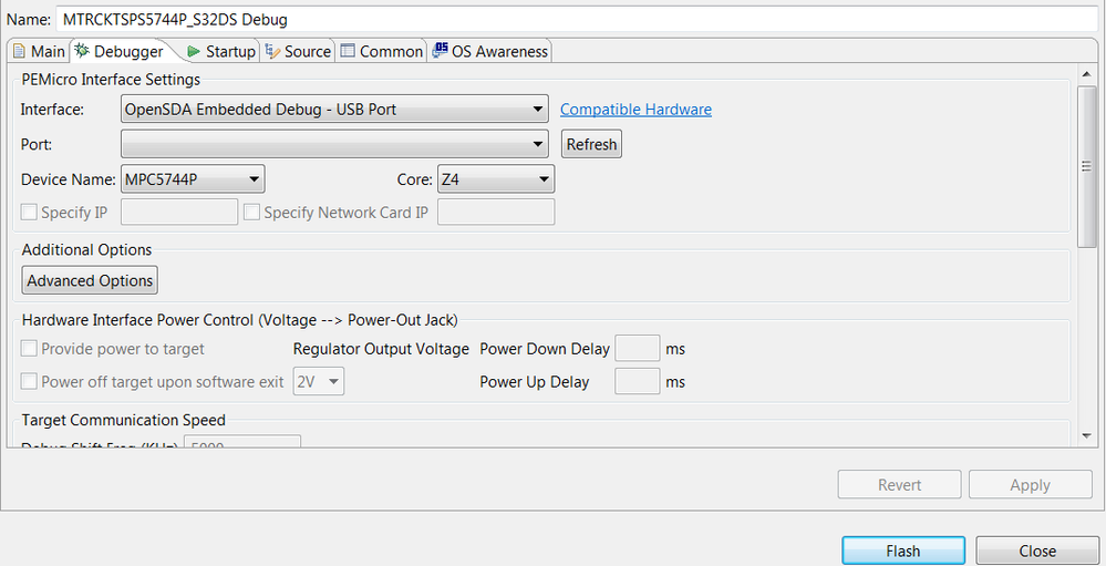

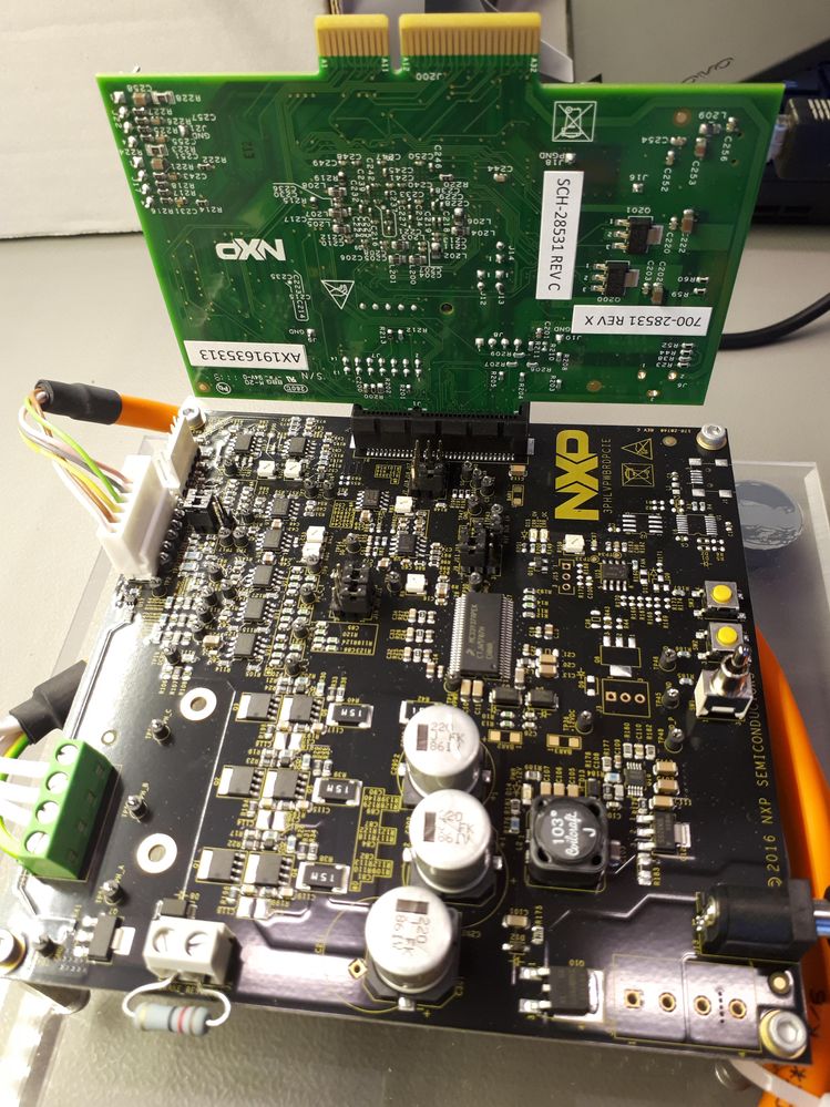

Starting with the MTRCKTSPS5744P_S32DS project example from NXP on the S32 Design Studio, I could build the project, but I can not flash the .elf file into the board.
The configuration is the default as follows:

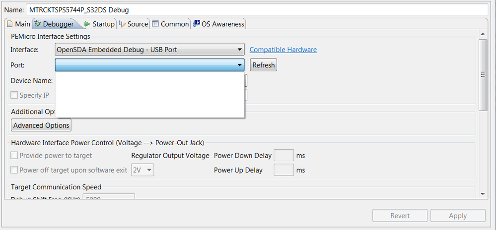

No port connection can be found in order to flash the code in the board.
Also I could connect the MTRCKTSPS5744P kit via the USB port interface to the FreeMaster with no problem.
How can I flash the code to the MTRCKTSPS5744P?
Kind Regards, Rafael

Hello b55689‌,
I am using the MTRCKTSPS5744P Dev Kit:
3-Phase PMSM Motor Control Development Kit with MPC5744P MCU.
The S32DS:
Version: 2017.R1  Build id: 171018
I also tried to use the OpenSDA interface as you can see below:

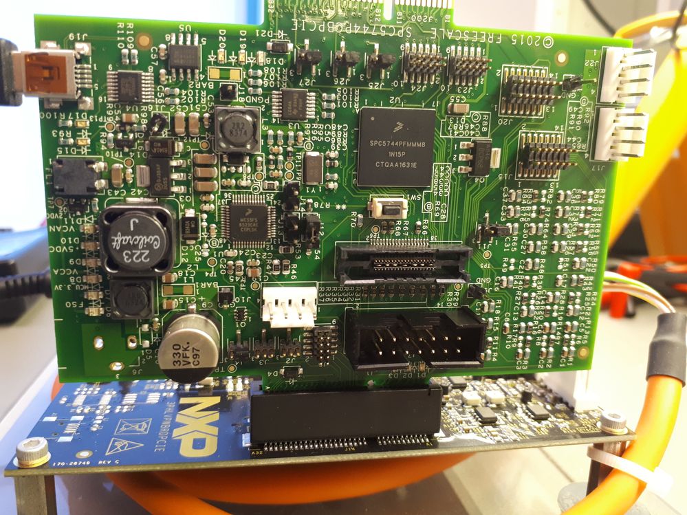

Please see the board images attached:20190515_105422.jpg20190515_105437.jpg20190515_105518.jpg:
Thank you.
6,029 Views
martin_kovar
the board you use does not have openSDA. There is standard JTAG connector only, so you must use debug probe with JTAG for example PeMicro Universal Multilink or some other.
Please see the document below (page 48) and check the JTAG used on the board.
https://www.nxp.com/docs/en/user-guide/MTRCKTSPS5744P-UM.pdf

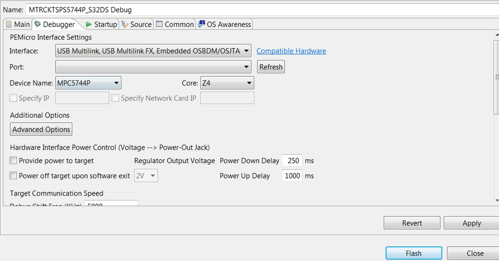

I am trying to connect it via JTAG connector using hte Lauterbach Power Debug Interface / USB 3. The driver is already installed properly,
but I can not access the USB port via S32 Design Studio.
Do you know if it is possible to flash using the Lauterbach debug interface?
If yes, how can I set up the S32DS in order to use this interface?

martin_kovar
I do not have much experience with Lauterbach plugin in S32DS, because I use Trace32 software directly.
Could you please try to flash this motor control software using Trace32 and let me know, if it works correct?

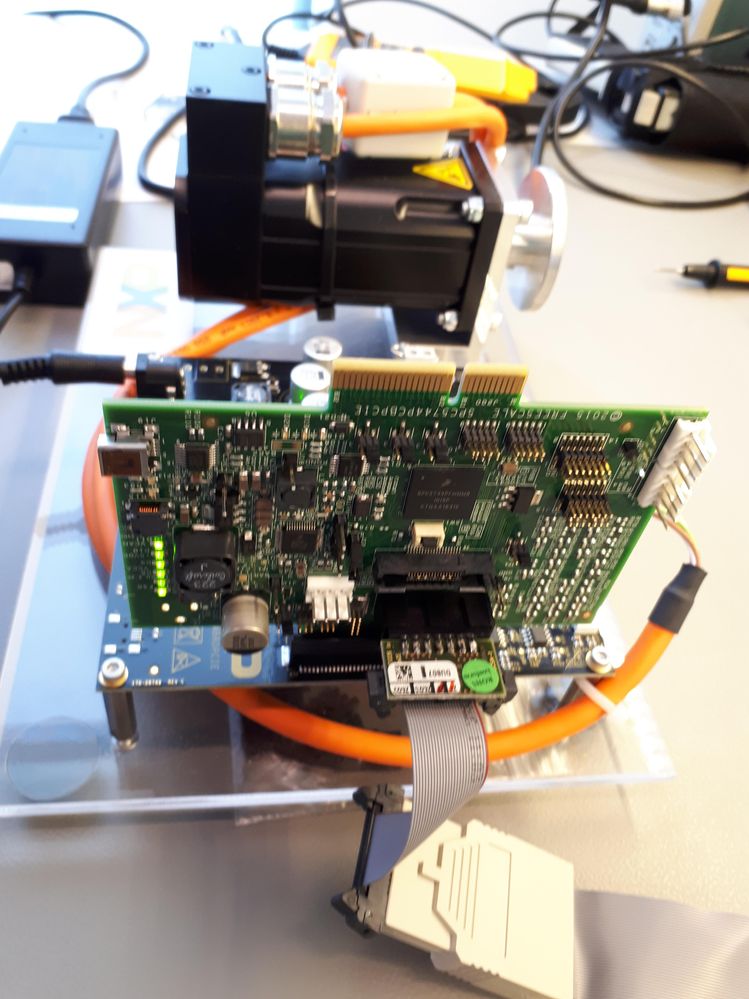

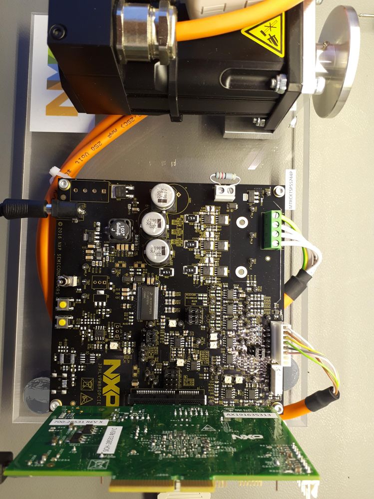

Could you please show me your Lauterbach debug configuration in S32DS and also some photo, how you have Lauterbach debug probe connected to the board? Please also be sure, development board is correctly power supplied before you try to connect using debug probe.

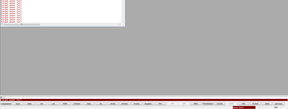

Would you have some guideline document to flash the .elf file via Lauterbach Power Debug Interface?
I can not connect it. The showed error: "target power fail "

martin_kovar
Hello Rafael,
if message  "target power fail" appears, it looks like the power supply of the board is not correct. Please be sure your motor control board is correctly power supplied as well as your debugger is.
From the figure you sent me, it looks like your debugger is connected correctly. Could you please show me the screen of your Trace32? What happened, when you click button Detect CPU in MPC5xxx menu?
Martin

ext-rafael_barb
Hello Martin,
Indeed the power supply for the board is correct, because I could run the motor and also connect with the Free Master tool.
Please see the screen just after the "Detect CPU" command

ext-rafael_barb
Hello b55689‌,
Thank you for the response.
Indeed the default flash script worked well in the Motor Control Kit MTRCKTSPS5744P.
For the Dev Kit MPC5744P the issue was probably incompatibility between flashing code throught debug cable and the energy supply source from USB connection (instead of Power In 9V connection).
