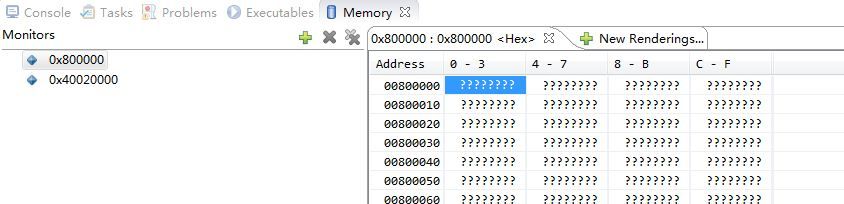

529610366
Thank you ,Stan.

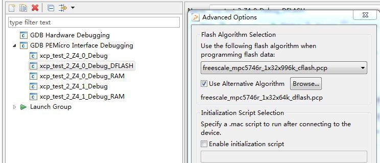

I  do following the document's step,the result in map file is correct,but I can't get the result at Memory Window.FLASH_ID.JPG
Path: C:\Freescale\S32_Power_v1.1\eclipse\plugins\com.pemicro.debug.gdbjtag.ppc_1.5.6.201703011834\win32\gdi\P&E\freescale_mpc5746r_1x32x64k_dflash.pcp
This is  the latest version of PEMicro Eclipse Plugin.

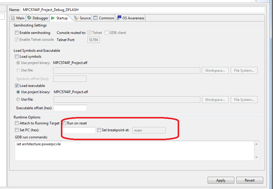

I suspect the core is running while you are trying to dump the dflash memory.
I'd recommend you to adjust your _DFLASH debug configuration and turn off "Run on reset" and "Set breakpoint at" options since they are not needed for dflash programming.
Make sure the execution is suspended when checking the memory view:
Hope it helps.
Stan

529610366
Thank you ,Stan.
The problem is solved.
