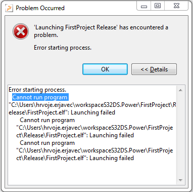

I have a problem running a new S32DS project on my MPC5744P board via Multilink Universal/JTAG. It builds correctly but when I try to run the application I get "Cannot run program" error.

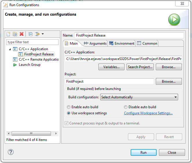

It could be that my run configurations are not set right. Can anybody tell me how to set them?

martin_kovar
did you execute your program using Debug icon or Run icon? There is some issue with Run icon, which will be fixed in next release. Now please use Debug icon. If this does not help, please look at the following thread

hrvojeerjavec
This explains the source of the problem, thank you. I managed to load the code to the board through debug.
