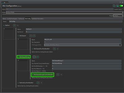

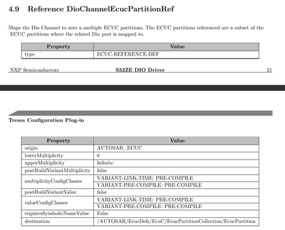

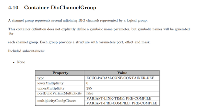

We do not have a proper MCAL training, however, you can find documentation on each module on their respective installation directory, for example for the Dio module C:\NXP\S32DS.3.6.1_2\S32DS.3.6.1\S32DS\software\PlatformSDK_S32ZE\RTD\Dio_TS_T31D53M20I0R0\doc, there you can find the User Manual, RTD_DIO_UM.pdf, where you can see descriptions of the configuration, for example:
In S32DS
in the user manual
