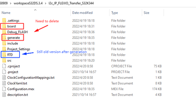

I am from the S32K3 APP team, We have released the RTD RTM1.0.0 Version half a year ago and quite a few customers are already writing the software for their products using it. Recently the 2.0.0 is released but we found a lot of problems when importing the 1.0.0 project to the 2.0.0 project. So my question is: Will the future S32DS and RTD versions can support this kind of immigration perfectly or do we suggest customers create a new project once a new RTD version is released? I can imagine the customers would not like to create a new project once a new RTD version is coming out instead of immigrating to the higher RTD version directly since they have already done quite a lot of work with the current project.
Problem 1:
The files in the board and generate folder have to be deleted manually first otherwise the new generate will only generate part of the files and some will still remain as the old version.
Problem 2:
The RTD folder which contains the driver still remains to be the old version.

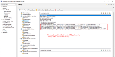

Problem 3:
The header includes path still remains the old version RTD path. Need to change manually.

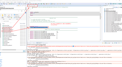

5. Some of the file names in the generated files are changed(Flexio_I2c_Ip_VS_0_PBcfg.h -> Flexio_I2c_Ip_Cfg.h) but some code(Flexio_I2c_Ip_Cfg.h) still used the old version RTD file name.

According to RTD team, they suggest that users can create new project using new SDK version, and then to reuse source code and CT configuration(.mex), they can copy them from old project to new project. RTD team is still working with finding a more convenient way.
