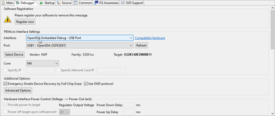

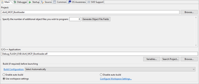

Debug/Flash Configuration settings:
Vijay_Arwapally_0-1627540968354.pngVijay_Arwapally_0-1627540968354.pngVijay_Arwapally_1-1627540993100.pngVijay_Arwapally_1-1627540993100.pngVijay_Arwapally_2-1627541021208.pngVijay_Arwapally_2-1627541021208.png
Attached are the build generated hex and extended hex files.

I suspect the problem in the debug session is caused by the fact the debugger set the PC to address 0x0 (see below). Typically this address is used for interrupt vector table and not for the application entry point. After reset PC is set to the reset vector and it works fine.
I'd suggest to untick "set PC..." option and re-try again.
Hope it helps.
