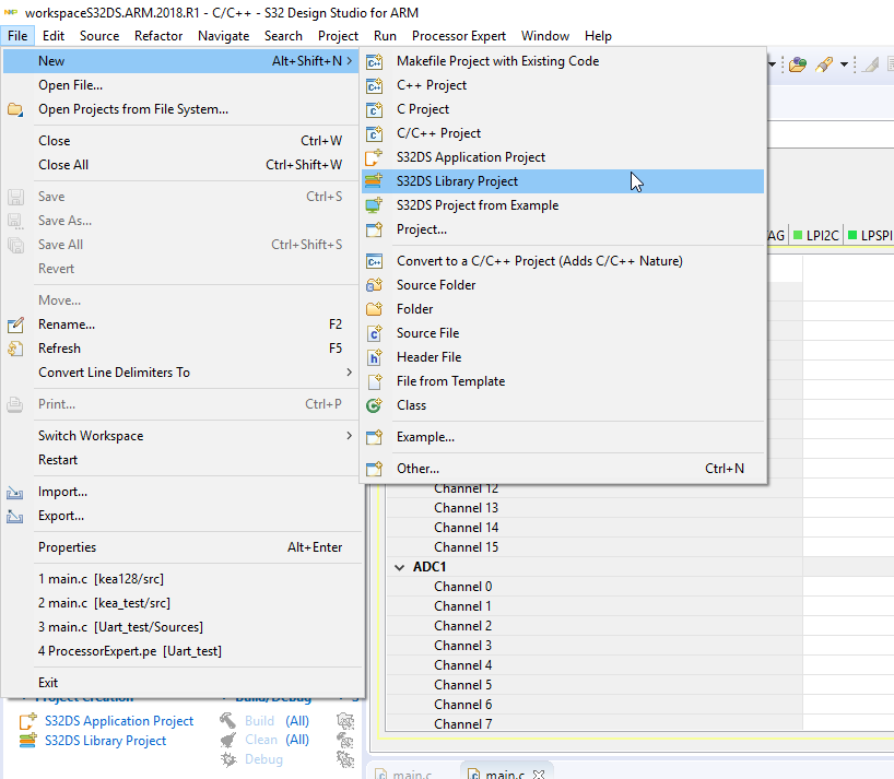

How to create a Library file from the S32 design studio. could please send for steps for  "How to create a Library file (lib.a) and How to build Lib source" from the S32 design studio.
Thanks & Regards,
Madhu Kumar N
1,930 Views
jiri_kral
there is option in menu - create new library project:

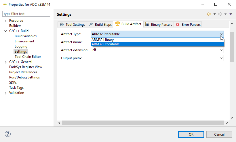

Other possibility is change build artifact in existing project - right click on project name -> properties -> settings:
Hope it helps.
