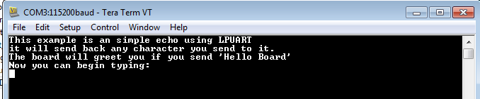

I am able to receive data from UART to serial.
However when I try to type on serial, it is not accepting from user. Below screenshot for reference.
S32 Design Studio is updated.
Any reason for this behaviour.

I had the same problem, I think there is some conflict with the ports, the example works with PTC ports PTC6 & 7 ,changing them to some other port and using LPUART2 was the solution for me!
