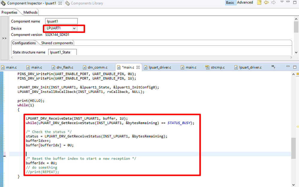

I try to use UART Communication together with an RS-485 IC (SN65HVD72DGKR).
Sending Text to an PC work correctly.
But I'm not able to receive some Text from the PC.
I checked out the lpuart example and also this topic in community: S32k uart RX interrupt handler problem
But the callback function never gets called.
Even if I take out the RS485 Transceiver and connect RX and TX to a loopback, the Callback never gets called.
I use LPUART component from Processor Expert (see attached project).
What could be wrong here?
Thanky for any hints.
Mario

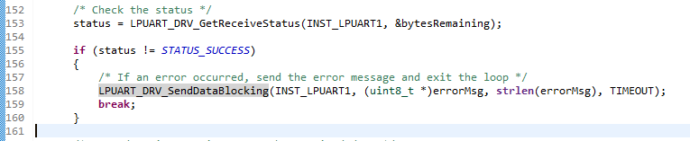

I imported the lpuart_echo_S32K148 example and changed the IOs to for my board. I also changed the clock settings according to my prototype board (Same settings as the attached project from the original question).
I could noticed, that the function LPUART_DRV_SendDataBlocking() doesn't work for me.
In my previous tests I used a function from ADC example where the function LPUART_DRV_SendData() is used.
So I did not receive any data on the PC with this sample programm. The programm also run in the part where the it will exit and stop:
I attached you the adjusted sample project. Maybe you find a mistake there?
Mario

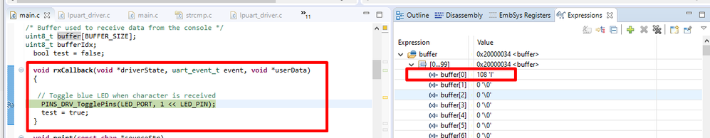

I have tested both your projects. Do you use your own bord?
With lpuart_echo_s32k148_2.zip I'm able to receive and transmit data without any issue.
With Test_UART.zip I'm able to get into rxCallback with code used from example mentioned above (just for test if it is working)
Diana

But also with this I have still the same problem that the Callback never get called.
I found another thread where someone has the same problem (s32k144 UART Callback )
The solution nearly worked also for me.
I attached the adjusted sample programm. There is a file with the code that worked for me.
It is strange that I always have to call LPUART_DRV_ReceiveData after sending some data, that I'm able to receive some data.
Makes this sense for you?
Regard
Mario
9,060 Views
Jeremy_He
Hi Mario. Yes, you have to call LPUART_DRV_ReceiveData constantly when receiving a new frame. This is how the SDK is designed. An alternate way is to call the set RX buffer function in the receive callback function.
