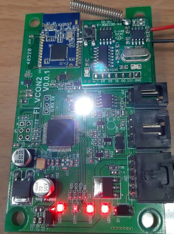

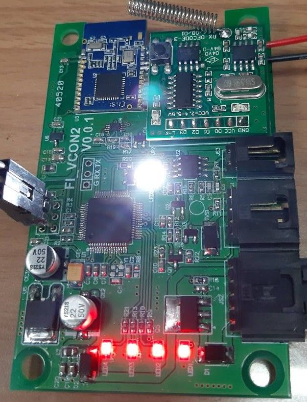

When I using J-LINK do step by step. PTB4 is correct output. Like LED3 in photo:31729.jpg
But,when I Stand alone by power supplier. PTB4 is strange. Like LED3 in photo:31728.jpg
PTB4 only supply 1.68V. Unlike other PIN supply 5V.

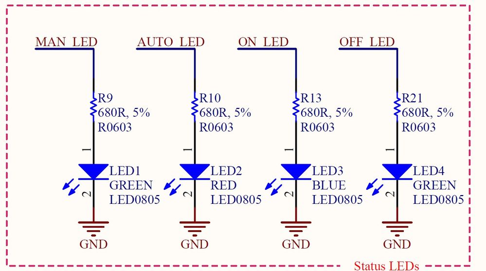

LED1~LED4 are same circuit design.The only difference is using  difference output pin in order PTC2,PTC3,PTB4,PTB5.
What difference between PTB4 with other?

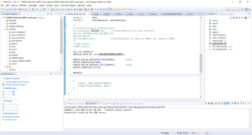

Program like this:

circuit design like it:
My program just let PTB4 output 5V. There are no other programs here.

Program like it:
typedef struct {
   volatile const uint32_t SRSID;
   volatile uint32_t SOPT0;
   volatile uint32_t SOPT1;
   volatile uint32_t PINSEL;
   volatile uint32_t PINSEL1;
   volatile uint32_t SCGC;
   volatile const uint32_t UUIDL;
   volatile const uint32_t UUIDML;
   volatile const uint32_t UUIDMH;
   volatile uint32_t CLKDIV;
} SIM_Type, *SIM_MemMapPtr;
#define SIM_SOPT0_NMIE_MASK 0x2u
#define SIM_SOPT0_NMIE_SHIFT 1
I can't understand what error with PTB4. Can you give me examples?
My program here:
PTB4.zip - Google Drive

Unexpected,when I remove the resistance which front the PTB4. I measured  it is 5V. I guess I have not success enabling High current drive for PTB4.
In my program:
SIM_Type SOPT0_0;
SOPT0_0.SOPT0 &= ~(1<<SIM_SOPT0_NMIE_SHIFT);
I have try to enabling High current drive.But it doesn't working?

In my opinion - your connection is acting as voltage divider for some reason - but it is hard to say why and how it is possible.
