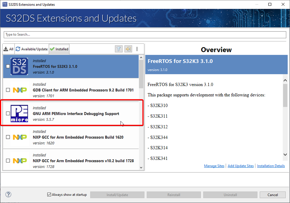

Please find the attched error message getting while hitting Run configuration.
There are different J-link open SDA-Generic firmwares? which one needeed to be installed?
hardware- s32k3x8EVB-Q289
IDE - S32ds3.5

it looks that you have PE Micro OpenSDA debug probe, not the J-Link one. You can fix it by create new debug configuration for PE Micro OpenSDA.

Inorder to create new configuration for PE Micro, that is not showing in the window(please refer the attached create,run configuration tab shared earlier).

did you updated PE Micro package to latest version?

Yes, it is latest version. While using run configuration option (PE Micro debugger is not poping uo) wheras in the Debug tab it is showing.
Here I don't want to debug, I needto run the code into the target prcessor(Evaluation board)
