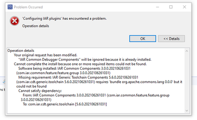

I had installed s32 design studios version 2.2, we need to install IAR for complier.
While installing it seems to have an issue like "Configuring IAR plugins" has encountered a problem.

Most likely the version of the IAR Plugin is not compatible with the version of Eclipse which is used by S32DS for Arm v2.2. Please confirm with IAR the correct plugin version to install.
