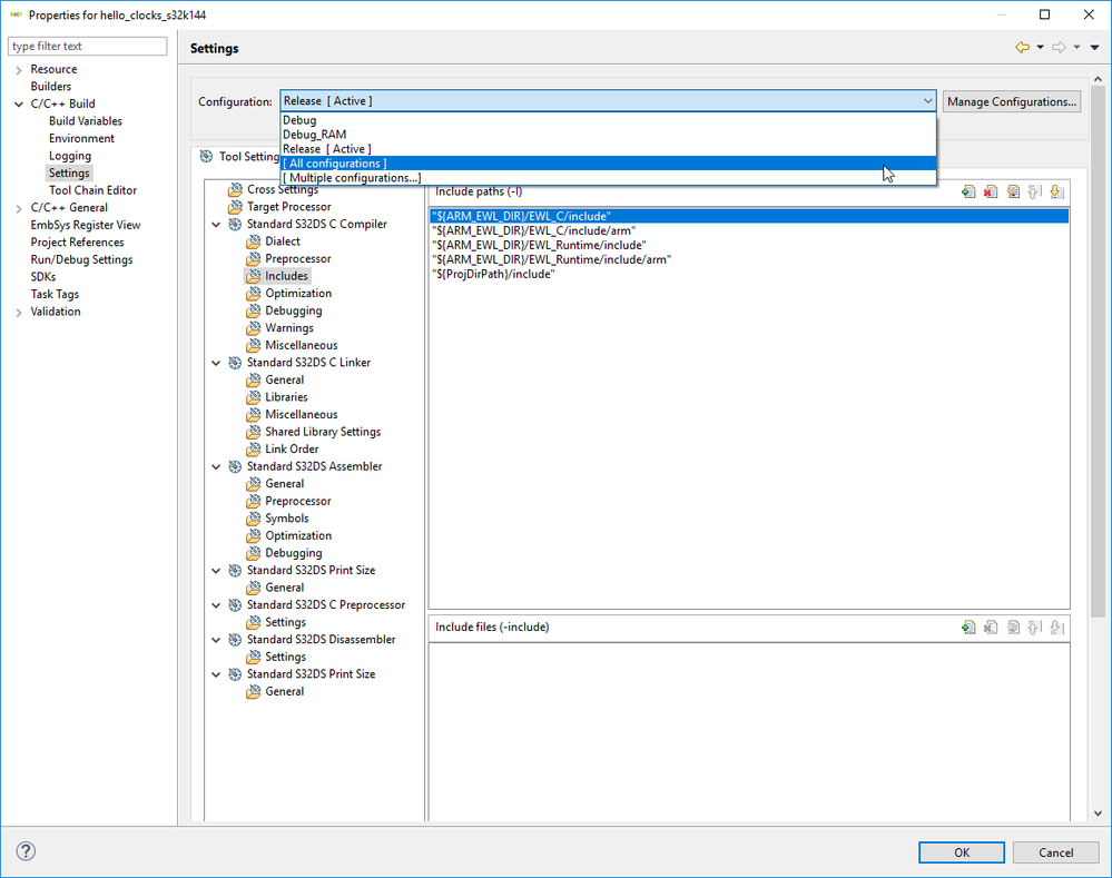

Hello Community,
I'm using S32DS IDE, and I have create a project.
In debug mode I can compile without problem but when I select release mode, the compiler stop due to "fatal error: XXX.h: No such file or directory"
And I saw too, on my workspace, only for release, the folder and files have a square on the left (see picture attached), so nobody knows where come from the problem ?

ok I found myself, in fact in click right on project -> Properties ->C/C++ Build -> Settings -> Standard S32DS C Compiler -> includes, there were not the same includes between debug and release.
So I copied these one of debug to release

jiri_kral
if you are creating new project - good idea is add shared Includes/libraries for all configuration together:
Otherwise you need to add your includes/libs for each configuration manually.
Hope it helps.
