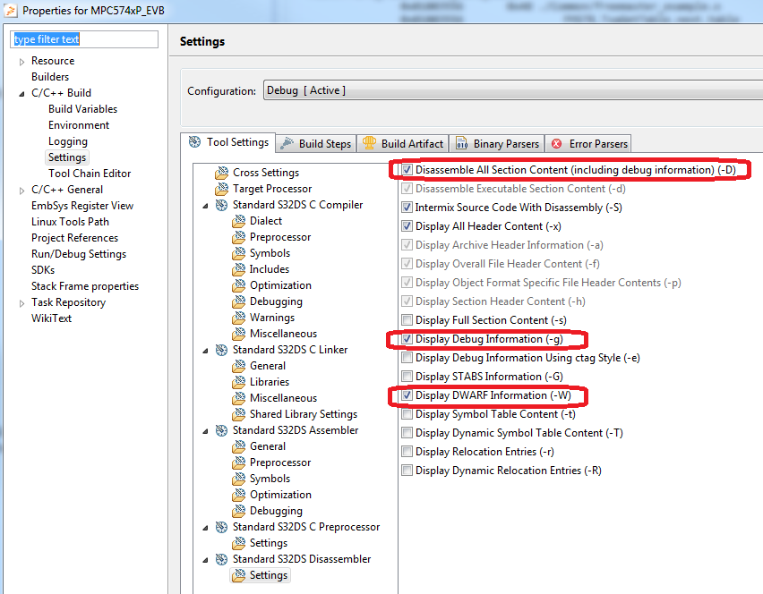

stanish
Hello Cheng,
I've built an elf file and set disassebler to show Debug information:
If I disassemble the generated elf - I get a lots of information about debug section/info - including e.g. DW_TAG_variable
Contents of the .debug_info section:

Could you please try to display it this way? If you are missing a specific information, could you attach short example + elf + description which debug information are you missing?
This will help us to resolve this issue much faster.
