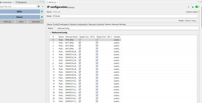

Below is the screen shot of my system's S32DS for platform 3.5 settings.

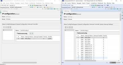

One of my colleague's S32DS has the Generic Interrupt Settings tab was present. But in my S32DS that setting tab was not found.
Kindly help to resolve this issue.

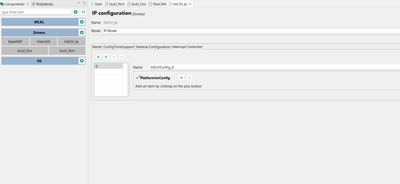

Hi @Riyasma07
I checked this in S32DS v3.4 and v3.5, and as it is shown in the below image, it looks like the new RTDs release Generic Interrupt Settings tab is no longer available.
