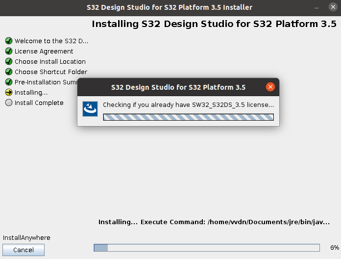

Maddy_Rakesh
Hi @jiri_kral
Is there any update on it -
As when tried to install in Ubuntu laptop - the installation process gets freezed in "Checking the License".. Kindly do the needful.

jiri_kral
sorry for delay. Unfortunately console mode is not supported in S32DS. S32DS can be installed only through GUI. Sorry for inconvenience.
