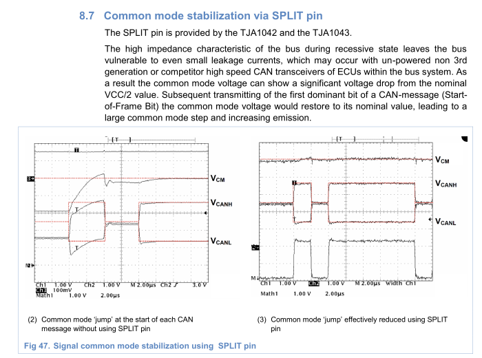

The application hints AH1014 then also describes how to deal with this situation using SPLIT pin. Of course, this needs to be handled by nodes which are not in standby mode:

Does SPLIT pin keep VCC/2 level in Standby mode?
If I look at the AH1014, SPLIT in standby mode appears to be floating, so can bus is gnd bias isn't the same?
Thank you for your help.
3,189件の閲覧回数
lukaszadrapa
No, it doesn't keep VCC/2 level. As I already mentioned somewhere above, this is up to devices which are not in standby mode.
