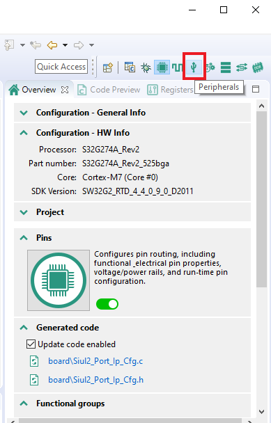

I have found the cause of your issue. You need to complete the S32 Config Tools setup and generate the code.
1) Double-click on the IPCF_Example_S32G274.mex file in the Project Explorer:

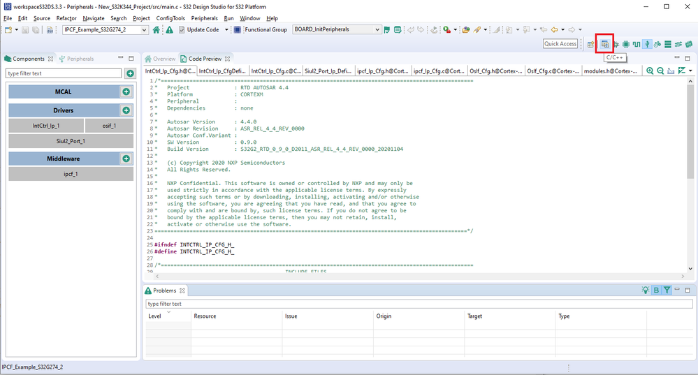

2) Switch to the 'Peripherals Tool' perspective:
3) Right-click on the error listed in the 'Problems' view and select 'Add SDK Component...':
4) Click Yes
5) Click 'Update Code'
6) Click OK
7) Switch back to 'C/C++' perspective and then Build.
The errors should be gone and the ELF file should be created.
