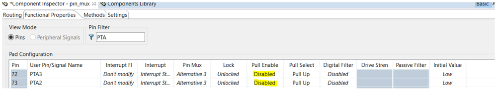

Have you tried using the lpi2c_master_s32k144 example? There you could see how the SCL and SDA pins are configured.
If you have configured the pins as they are configured in example, and it's still not working, I recommend to use external pull-ups. For this you need two pull-ups resistors of 4.7Kohm each. Wired one between VDD and SCL pin, and the other between VDD and SDA pin.
If you use external pull-ups resistors, you should disable the internal ones (see capture attached).
Please let me know if you still have problems.
