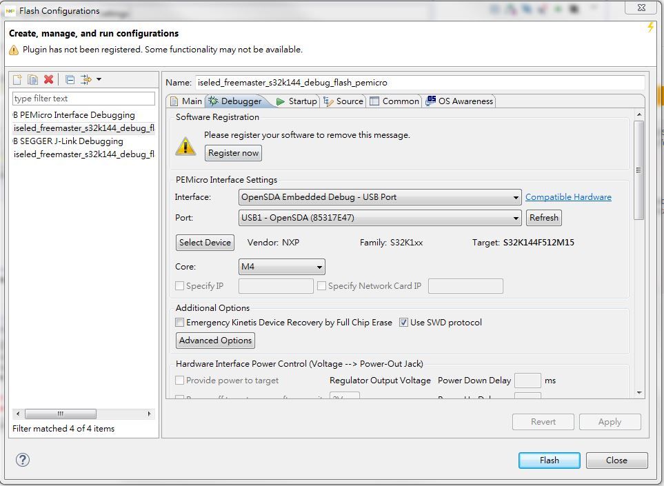

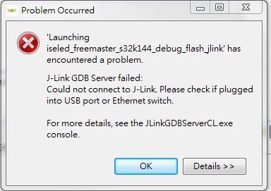

擷取.JPGI have an error when I am currently programming.I have confirmed that the current development version is connected.

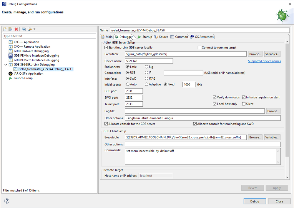

jiri_kral
I'm not sure what's you configuration, but if you like to use j-link as a debugger - you need to select it in Debug configurations:
Jiri
