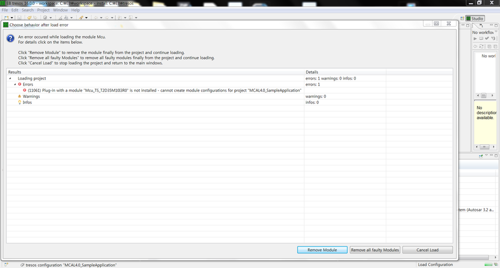

but I had some problem with Load error. blow is that thingspastedImage_3.png

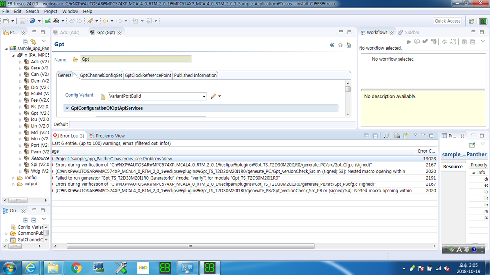

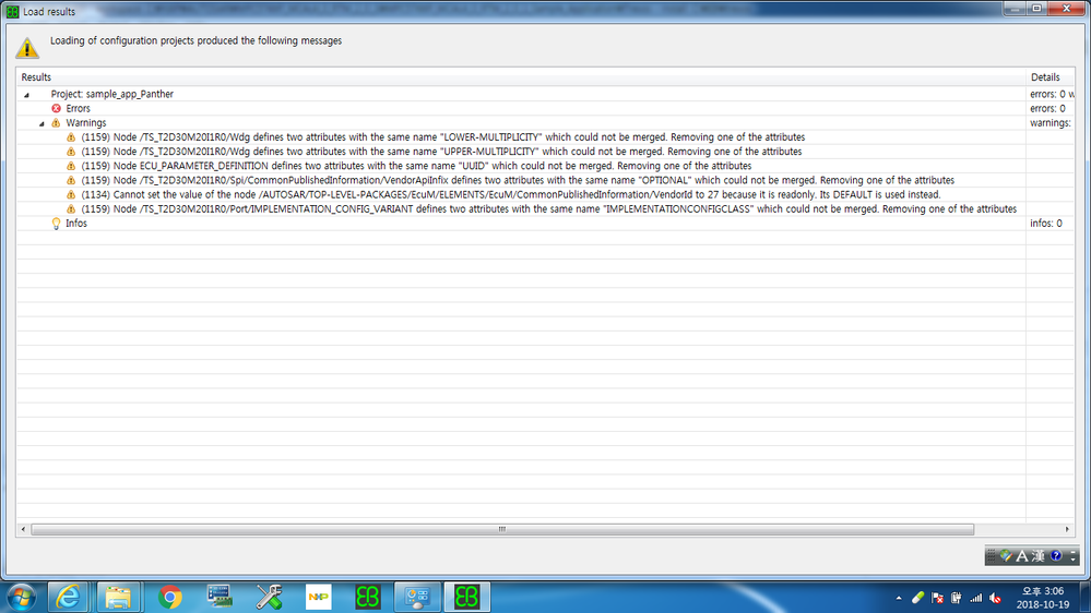

so, the load error is fine and we got the Warnings, however, I click the generate file, it has a lot of error. blow is that things
1.warnings file
2.error file
I want to know how to solve that problems
anyone, help to me

In case of the first image, it may be possible that you have the MCAL plugins for RTM 1.0.3, but you are trying to import a project created on RTM1.0.4 plugins (or vice-versa). You need to make sure that both MCAL plugins and the tresos workspace project have to the same release version.
The clue is given by: TS_T2D35M10IxR0 'code/id' which has to be consistent both in the names of the plugins (i.e. Mcu_TS_T2D35M10I4R0) and XDM files for workspace\[your_project]\config folder and/or EPC files from workspace\[your_project]\output\output.
Copy the TS_T2D35M10IxR0 id from one of the plugin folders and do a search for this code in the workspace from where you want to load the configuration. If by any chances these ID's don't match (i.e. you are using RTM1.0.4. plugins with RTM1.0.3 configuration) there are two ways to adapt the 1.0.3 configuration to match the plugins...
- go to each EPC file and change TS_T2D35M10I3R0 to TS_T2D35M10I4R0 and do a Import of the new module configuration.(see below)
- or  change TS_T2D35M10I3R0 to TS_T2D35M10I4R0 in ALL xdm files... and re-import the entire project (and pray :smileyhappy:  because this doesn't always work)
The second issue is a bit strange...
First make sure that you use the correct Tresos version (24.1.0 or at least 24.0.1). There are some major differences between these Tresos versions regarding AUTOSAR variant handling concept which impacts how configurations are generated/handled by the tool.
Also, make sure that your are not mixing releases.... MCAL MPC574xP configuration will not work with MPC574xG
plugins or vice-versa.
There may be the case where your tresos project paths get (somehow) mixed and you might not be able to correctly load a project. In that case, the best solution is to create a NEW project from scratch AND import the EPC files for each MCAL module, by using Import option from the project specific context menu. (I attached some pics on how to do all this)

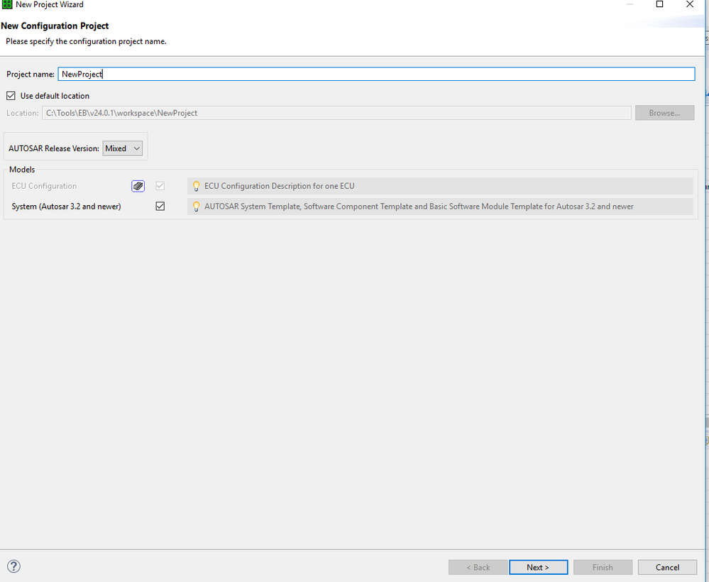

First create new from: main menu/File/Configuration Project
Note. you can provide any name you wish to the project, but I suggest you use one that actually represents the platform and release version you are working with (i.e. MPC574xG_RTM100_asr4.3). Also, AUTOSAR release versions can be Mixed or 4.3.1 depending on your needs... (for now, you may leave it as ''mixed'')... press next and...

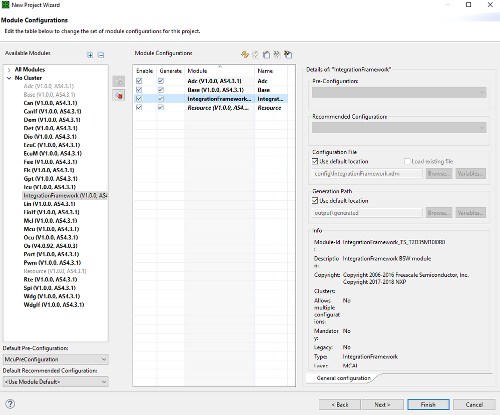

add platform specific information...
Note. for MCAL configuration Ecu ID in not really important. However, for a series project where other ASR components will be configured, it may be a good idea to have this name consistent with the ecuc name where you will store the entire BSW configuration (though import options should work nevertheless)
Press next (not finish) so you can add which modules you want to use...
The MPC574xG ASR4.3 RTM100 release should contain the following modules configured as part of the "sample application" which is, now, called "Integration framework": Adc, Base, Dio, Gpt, Ocu, Mcl, Mcu, Pwm, Port. You need to add all these modules to the configuration and press finish.

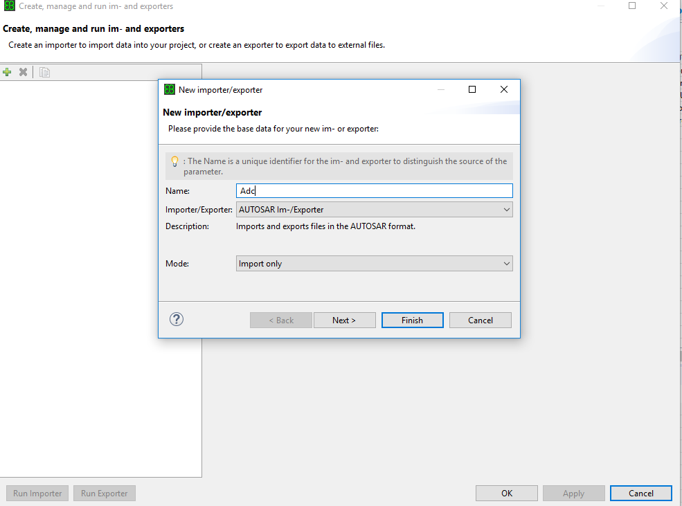

Your project should now be created and you should have access to un-configured modules. you need now to import the epc files that where provided for the release by pressing right-mouse-click on the new project to open the context menu import option:
Press the green plus from the next window and this will create an 'importer' for each module... Adc_import.PNG
Pressing Next will allow you to configure from where to actually import the file. Make sure to use 'Replace' as Import Strategy, to avoid mixing types and also Content type should be: asc:4.3.1 (or what ever ASR release version you are using).
Browse to the output folder where the epc files are stored (on your machine), select the corresponding module and press finish.
Press Run Importer button and you should have an up-to-date ADC configuration... Rinse and repeat for all other modules ... and you should be able to generate the code...
