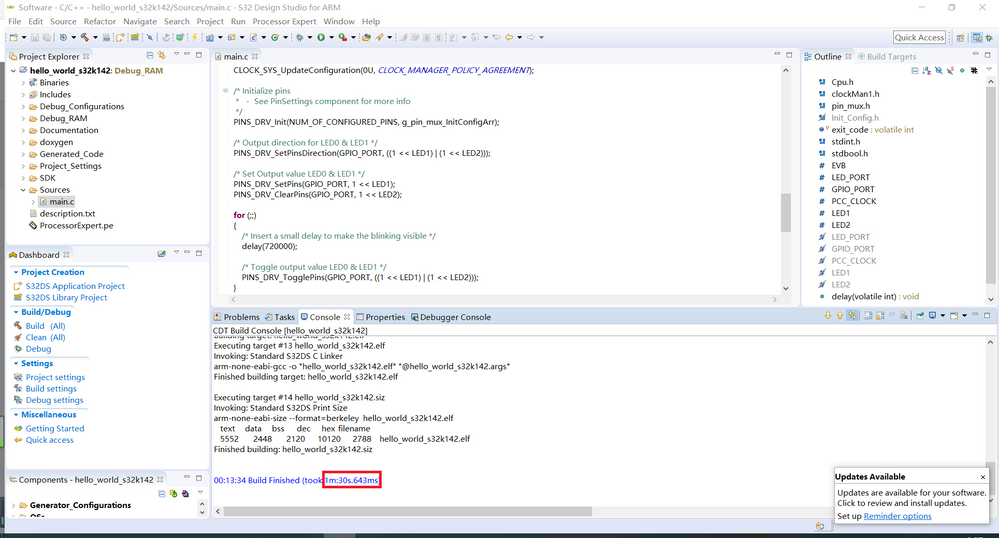

Hi!
 Recently I find that building projects becomes slow using S32DS , it takes almost 1 second to update a row of information on console when building projects . Totally , it takes 1m : 30s.643ms to finish building demo project hello_world_s32k142 . I have no idea what causes this issue because I do not change any project setting and compiling projects was fast a lot before.

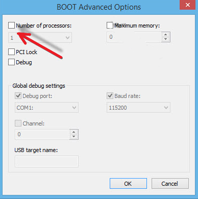

XU_Boost
 The solution I found is that changing the Number of processors to 12(Maximum value for my PC) from a default state of the following picture...after resetting my PC, building project becomes so fast!!! (PS:But it confuses me is that Windows 10 OS should get Maximum Number of processors from PC under that default state according to https://answers.microsoft.com/zh-hans/windows/forum/all/msconfig%e4%b8%ad%e7%9a%84%e9%ab%98%e7%ba%a7....)
