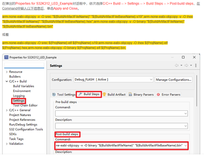

How can I generate both of the bin and hex files at the same time after building?
I'm using S32DS for ARM v2.2.

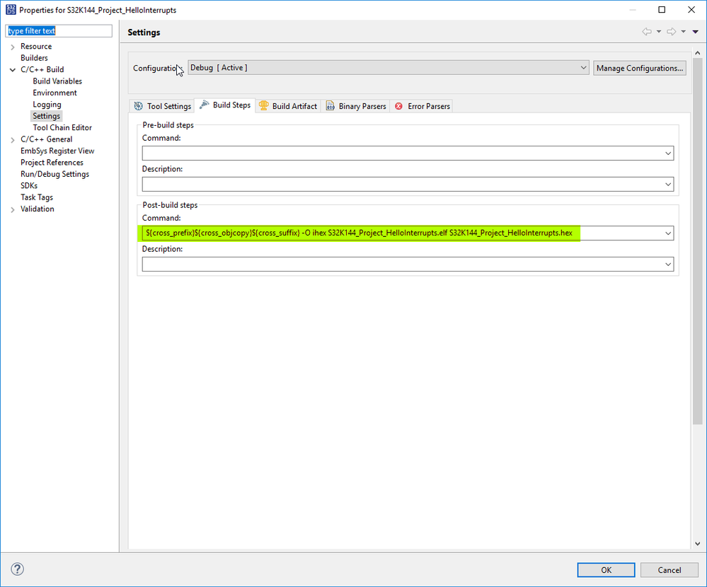

Hi Kate,
you can create .bin file by normal way in project settings and .hex file in post build steps in project properties:

Hi Jiri,
    I build the project to generate the bin and hex files according to your ways, but if failed.
    How can i do for it?
