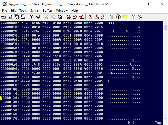

Your .out file is probably .elf file. Just check the file header in some text editor. Should start with .ELF like this one:
You can also try to rename the .out file to .elf file - if it is elf file format.

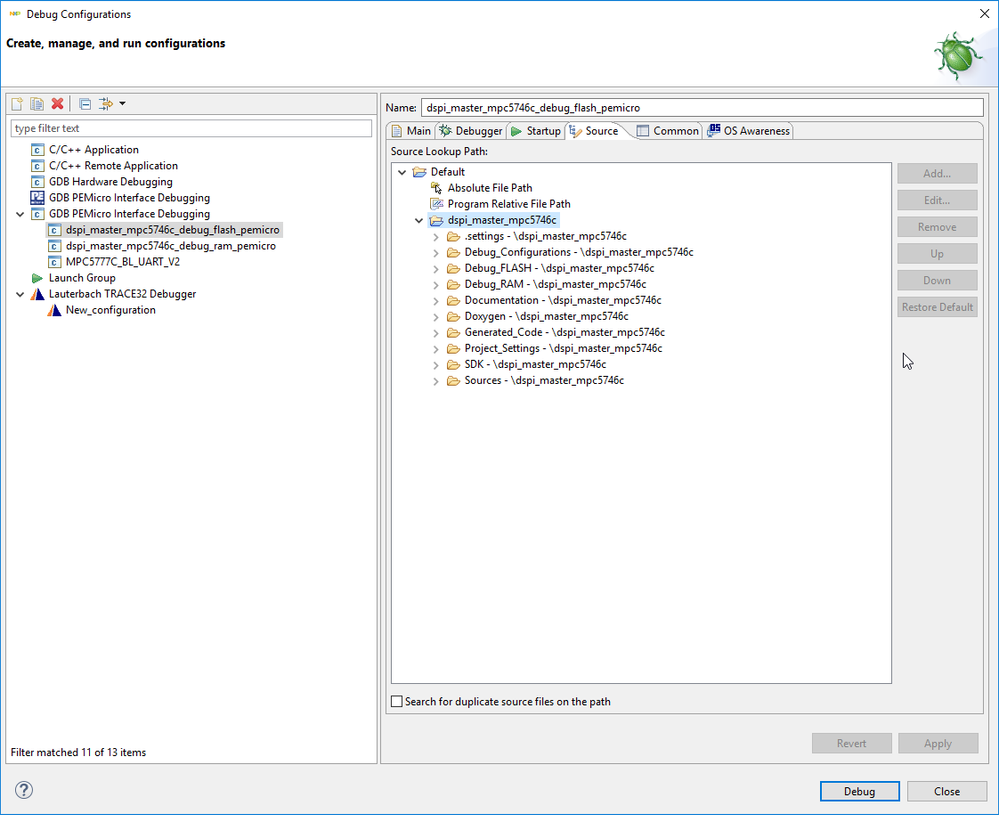

bingwang312
Error : Error in ONCE status register during instruction execution.",  i am also suffering on this issue. somebody said it might be the shift freqency problem, it is the communication speed between debugger and software, by default it is 5000khz which might be too high for some chips.
I checked debug configuration, the communication speed is 5000khz, it is gray color , how to change this speed lower ?
