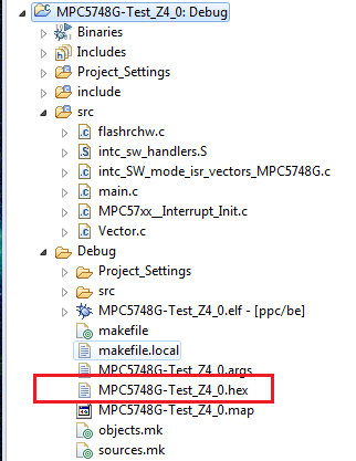

     I'm planning to work on a bootloader project for my MPC5748G. *.elf file can't not be parsed easily, so I want to convert it to *.hex file. Is there any build-in tool in S32 that can do this job?

you can also create .hex file directly in design studio. Open project properties and C/C++ Build -> Setting. Check Create flash image button and click OK.
Now open project properties again and choose Standard S32DS Create Flash Image -> General. There are four output file formats and one of these is Intel HEX. Choose HEX and click OK. Build your project once again.
After the build, hex file is placed in Debug folder.

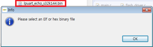

I'm trying to use the S32K144 chip. When I tried to flash the "bin" file to S32K144, it failed.
Doesn't S32K144 support "bin" type? "elf" and "hex" work well.

Great! Thank you very much, it works.
