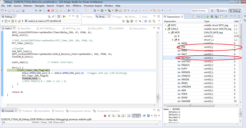

1,546 Views
fuqinwei
The register of CAN0.MCR.B.NOTRDY and CAN0.MCR.B.FRZ is always keep 1 ,even thougth the CAN0.MCR.B.HAL was set to 0
