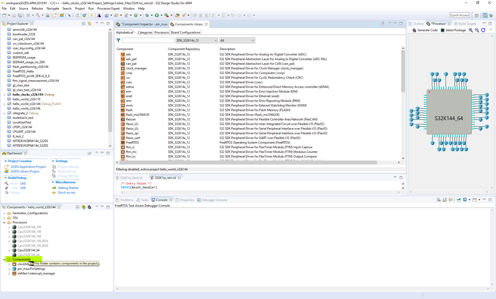

Anyone know how to change the package for exist project? e.g, i create an hello world project from S32DS sample project, the package is 144, but i don't want to use 144, how to change it?

jiri_kral

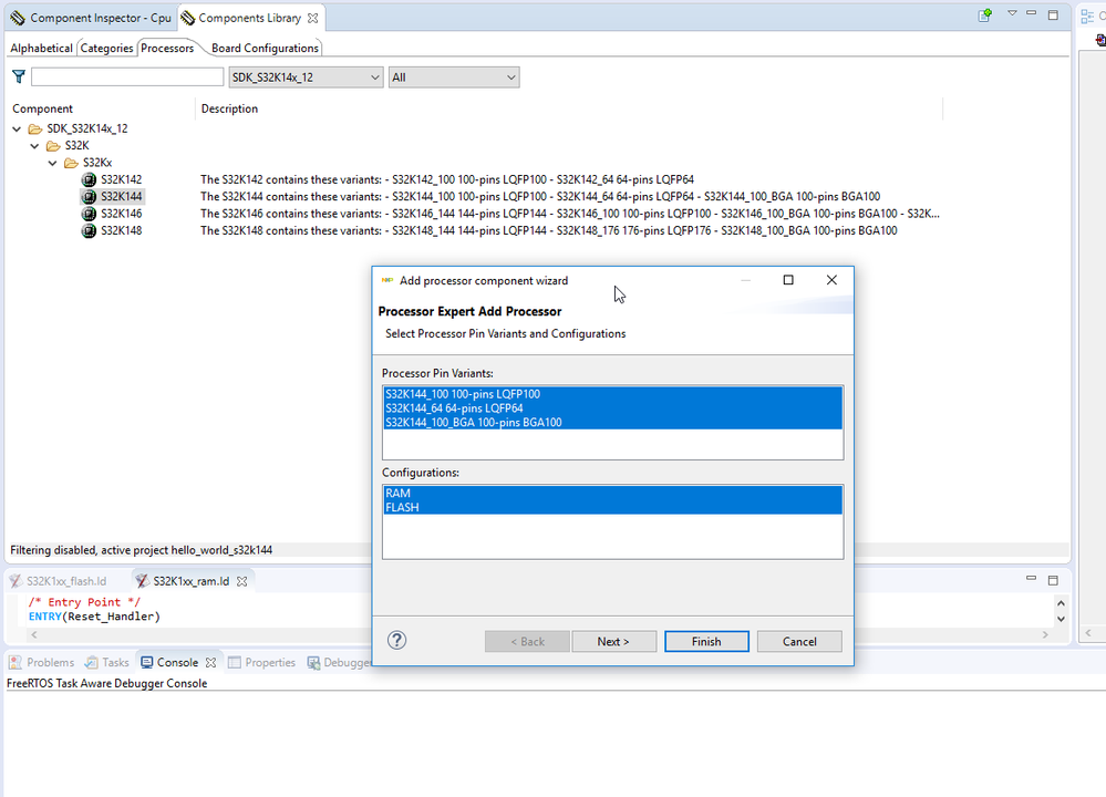

Double click on components
in component library choose processors and Package layout you are interested in:

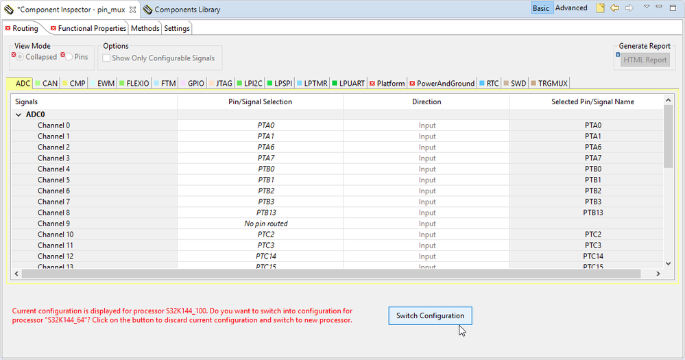

Change the PINMUX settings according to package layout:
Hope it helps.
