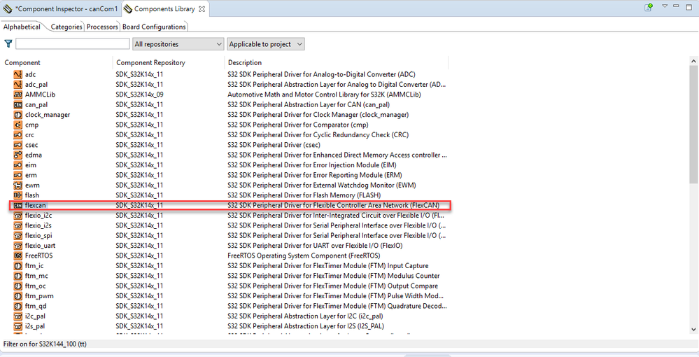

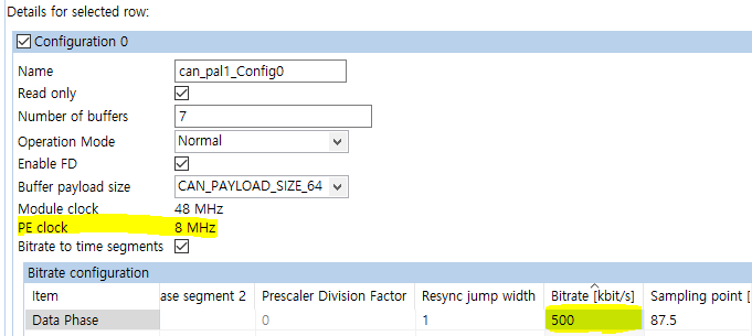

I want to set CAN bit rate to 5Mbps.
But at PE clock 8MHz, max bit rate that I can set is 1Mbps.
So I want to change PE clock, but I don't find how to change PE clock.
Please let me know how to change PE clock.

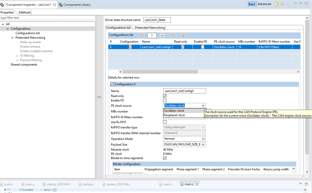

use flexcan module instead of can_pal module. Flexcan module allows to set PE Clock in processor expert. See the figures below:

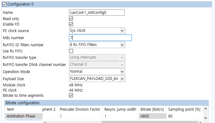

I changed PE clock to 48MHz.
But at 48MHz PE clock, Maximum CAN FD bitrate is 4.8Mbps.
I can not set over 5Mbps.
I want to set over 5Mbps.
How to set 5Mbps CAN FD?
