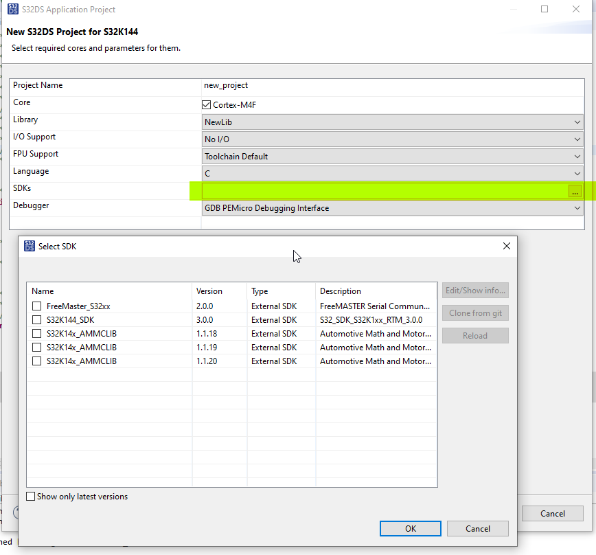

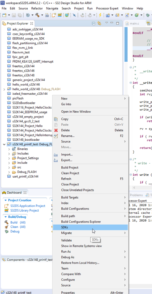

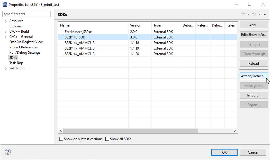

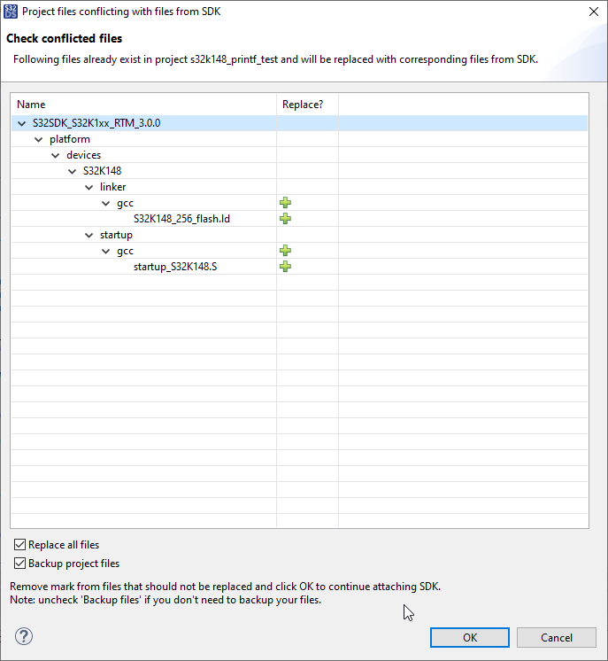

Processor Expert is part of SDK, you need to add SDK in your project:
Other way is started new project and add SDK in project wizard:
Hope ti helps.
Jiri
3,676 Views
jiri_kral
Hope ti helps.
Jiri

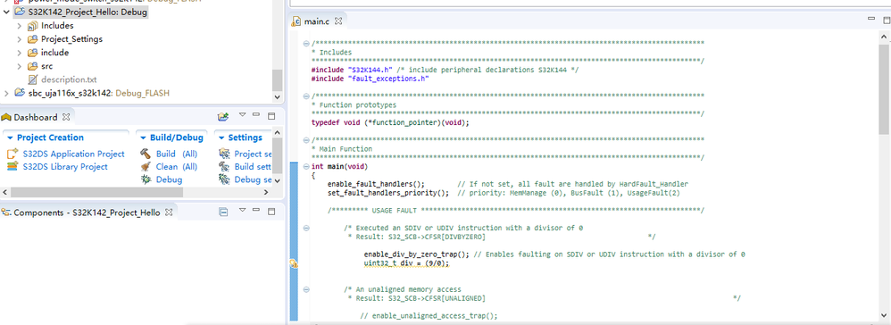

Hi erich,
but In S32DS for arm2.2 menu File > New > Other , there is no such choice,
