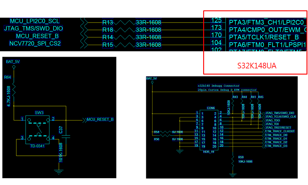

I made a board for my project.
I designed like that attach the image.
I connected Pin170(reset) and Pull up with the switch.
but voltage muresed always low signal(about 0.1V) at reset pin. so i think i can't debug using the JTAG.
can you plz check this port and my schematic.
