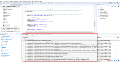

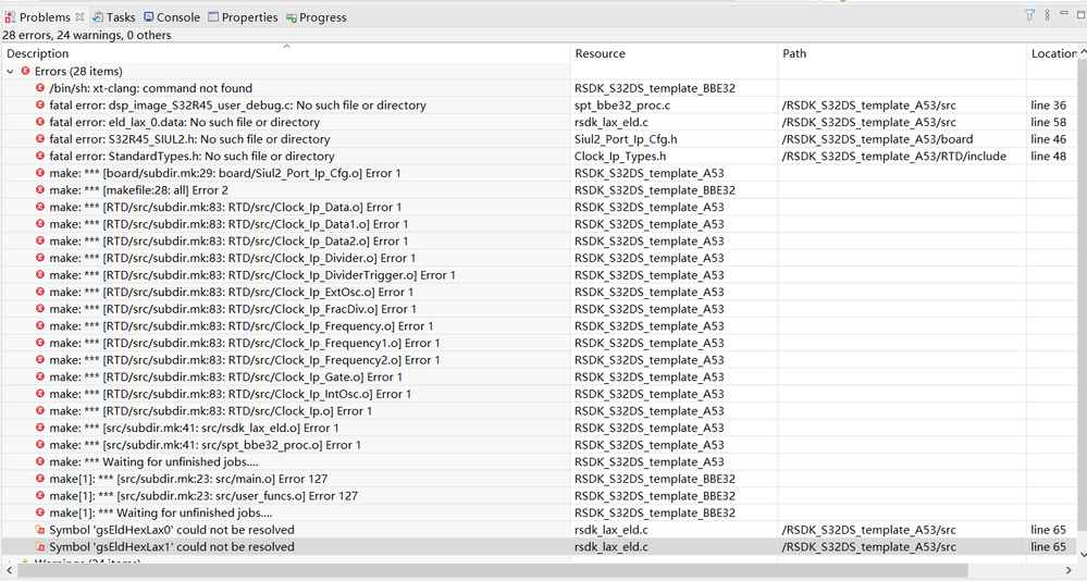

HI,
   I follow the Step:"HOWTO: Create New Project from Example ‘RSDK_S32DS_template’" Create my Project successfully. Link: https://community.nxp.com/t5/S32-Design-Studio-Knowledge-Base/HOWTO-Create-New-Project-from-Example-...
but build all the project,Many errors occurred. How to solve it?

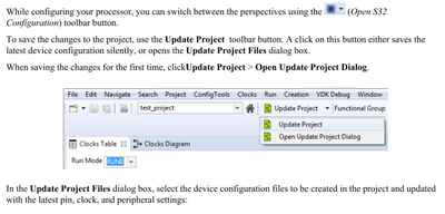

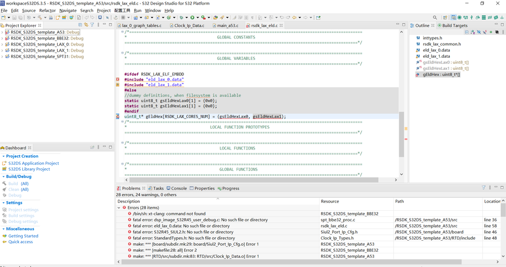

jone_yang
i update the code for the projects by suggest,then build again.
the another errors occured!

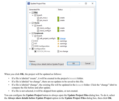

lukaszadrapa
it looks like the files are not generated. You need to update the code for the projects:
lukaszadrapa_0-1661415910590.pnglukaszadrapa_0-1661415910590.pnglukaszadrapa_1-1661415931101.pnglukaszadrapa_1-1661415931101.png

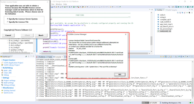

jone_yang
add on the package :"BBE32 DSP Add-on package 1.2.0 for S32 Design Studio 3.4 Update 1",build again,then license error occured.

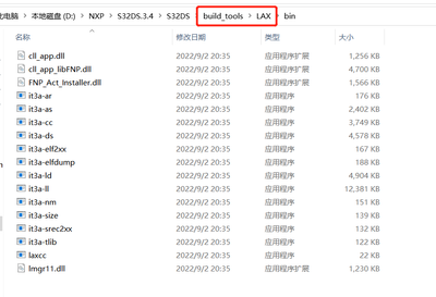

jiri_kral
did you download and install LAX compiler?
Jiri

jone_yang
Hi, the LAX compiler installed
