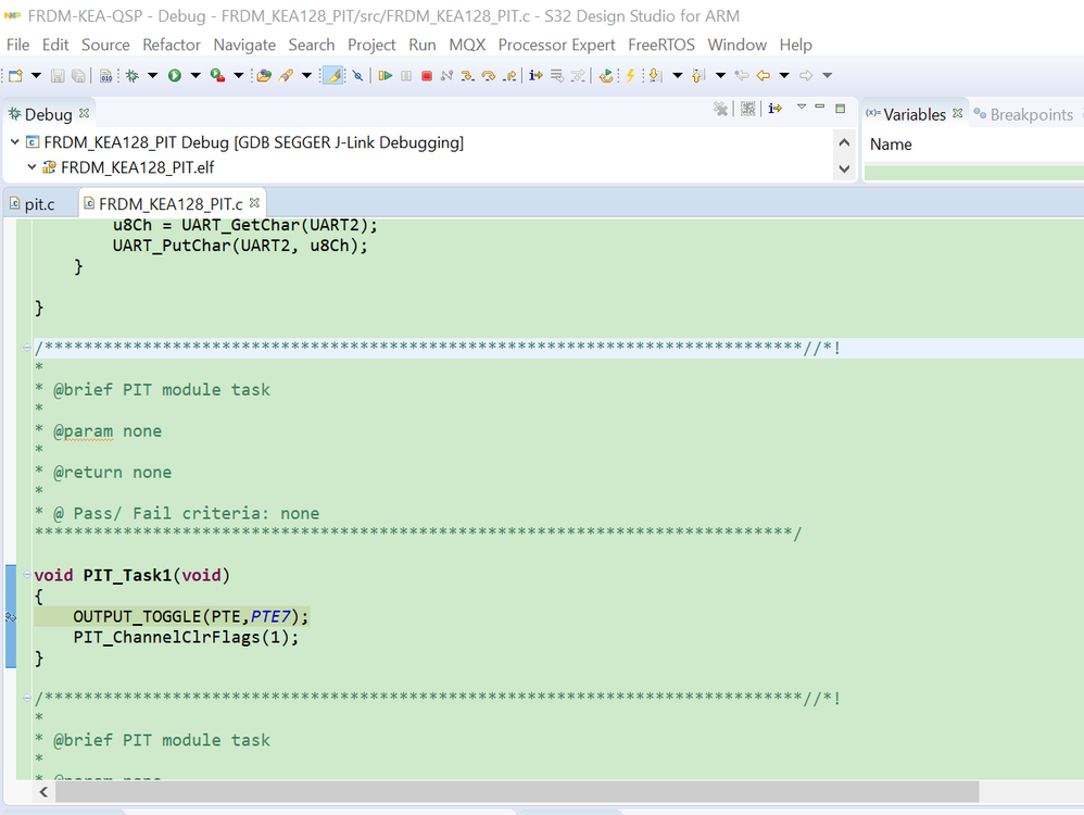

I have tried the newest QSP, the following interrupt works:
\FRDM-KEA-QSP\Code Project Examples and Sample Drivers (Evaluation Grade Only)\FRDM-KEAZ128\Driver Test SW for KEAZ128\FRDM_KEA128_PIT
I attach the project directly, you also can test it on your side.
You can unzip it and import it your S32DS 2018
Wish it helps you!

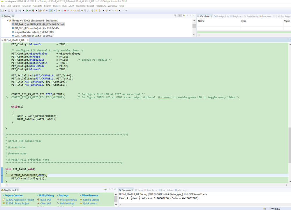

I downloaded your example, “FRDM_KEA128_PIT”, and tried to run it on both S32DS for ARM 2.2 and on S32DS 2018 R1 IDEs.
When trying to open the project in S32DS for ARM 2.2, and after cleaning, Compile gives me all these errors. I have no idea how to fix this.
On the S32DS 2018 IDE I was able to import the project and compile it, however the program hangs at this line in the code:
I have attached the ONLY interrupt example project that I have been able to find that works on both IDEs. It is essentially the same idea, using the PIT to generate an interrupt every 1 sec, and toggle the Blue LED every time the ISR is run.

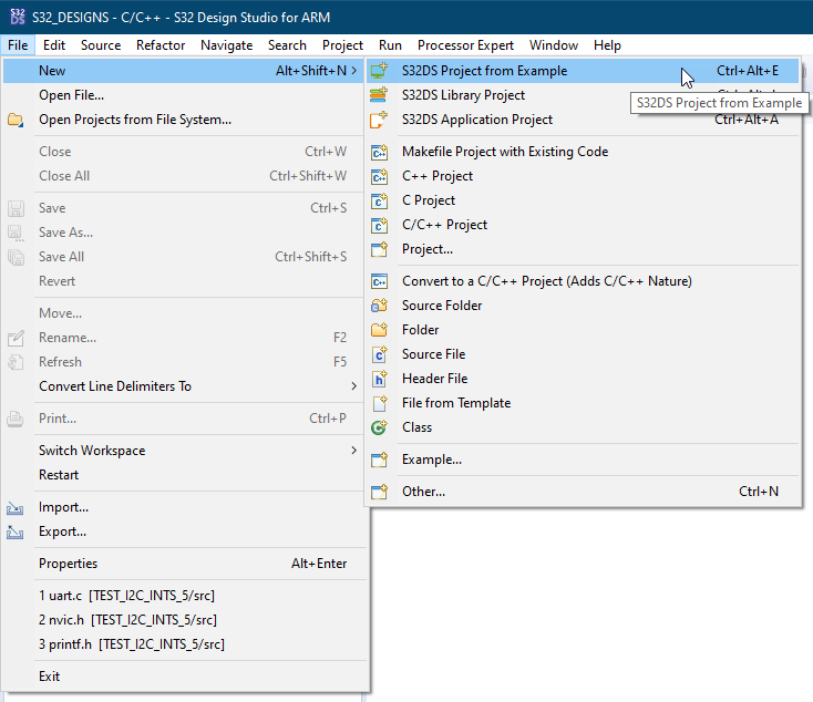

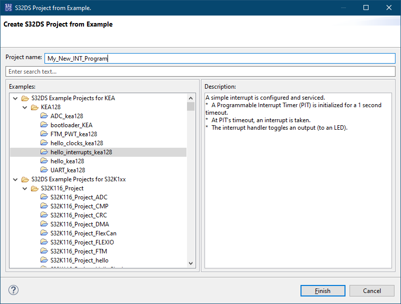

File --> New --> S32DS Project from Example:
Wait.... Wait some more... Until the sample files dialog opens up.
Select the KEA128 example "hello_interrupts_kea128", and give it a new name.
Press the [Finish] button.
Now compile it, and the Blue LED blinks at a one-second PIT interval, as advertised. Happy joy. I can adapt the PIT example to handle external interrupts, the ADC, but then all the interrupt sources have to use it. I can't believe that this is how interrupts are supposed to work on this MCU.
If I simply create a new S32DS project and import all the relevant *.c and *.h files, the program will compile OK, but the PIT interrupt never happens! In fact, none of the interrupt examples from the FRDM-KEA-QSP KEA128 drivers work, not even using the method I explained above. Only this example, imported the way that I described.

So Kerry I did get the following to work, produce interrupts, but I don’t understand the difference of this type of project. Why does it work, and a project where I just add source files to a project.
Anyway, when I use FILE--> NEW --> S32DS PROJECT FROM EXAMPLE, wait for the dialog to fill with options, and choose “hello_interrupts_kea128”, I get a project that I can compile and when it runs, the interrupts are working!!
Why can’t I just start a new project and copy the same source files to the project, and get it to run with interrupts??

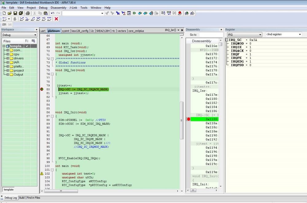

  When you can't fire the interrupt, do you enable the global interrupt? and enable the module interrupt, and write the related ISR service code?
   Share you one simple IRQ interrupt KEA128 project, which is the IAR project, it has been tested on my side, and the interrupt works, you can check it on your side.
