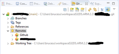

I added my project files to git from the Git View of S32 design studio and it works. But when I open the Git Staging page It shows No Repository Selected.
How can I see the information from Git staging Window?

bjs
Yes. I works as expected.

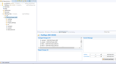

Hi Bruce,
I've just done a quick check; I created a new example project and add it on a brand new git repository (TestRepo) via:
Project menu -> Team -> Share Project...
and it works as expected on my side. I can see the Repository name and unstaged modified files:
Can you try it the same way?
