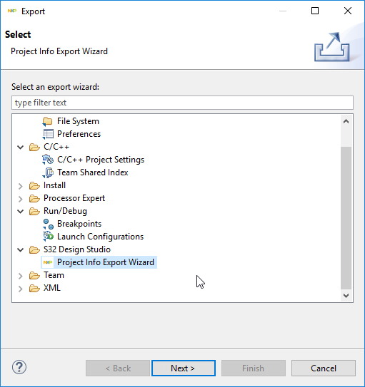

You can get ProjectInfo.xml file where is list of sources. Right click on project name -> Export -> S32Design Studio -> Project Info Export wizard:

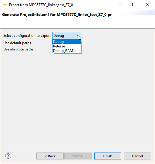

Select configuration you are interested in:

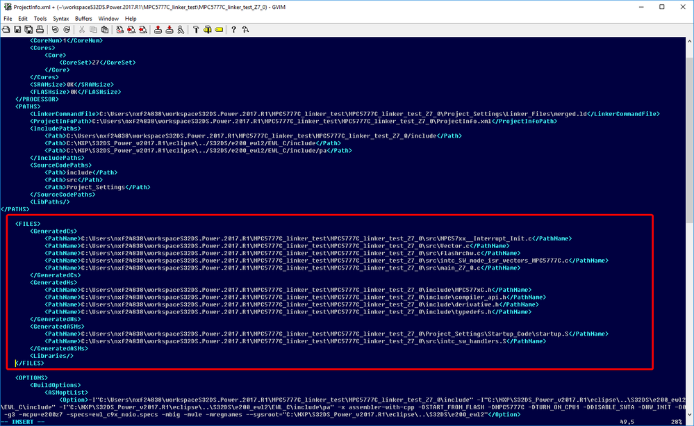

After finish you will get ProjectInfo.xml file in project root folder:
