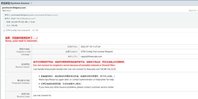

There's no email address can get trial license code.
Software send email automatic , the email address is not nxp but freescale  and it's returned by reason "Can not connect to recipiet's server because of unstable network or firewall filter"
So is there any way could I get the trial license? Thank you!

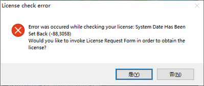

Dear Mike:
there's an error , it prompt that system data has been set back.
The system data cannot be setting because there has a software locked it on our customor's system.
Is there any solution can be solve?
9,460件の閲覧回数
mikedoidge
Hello @lihui1,
This error message is from the FlexLM license management software. It is indicating that the time/date of the host machine operating system was modified. This is intended to prevent users of a FlexLM licenses application from extending the usage of the application past the license expiration by changing the system time/date of the OS to a time/date in the past. I think there is no way to disable this security feature. Is there some other host PC which could be used? I could provide a new license for a different PC.
