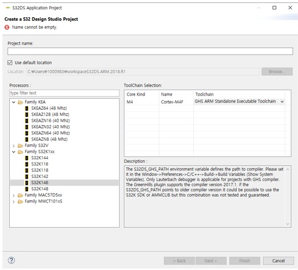

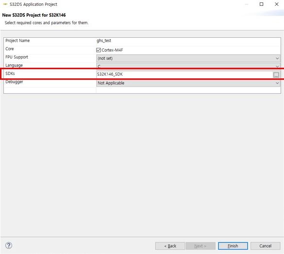

Could you help to add the GHS toolchain project in debug configuration?
Create a project as below.

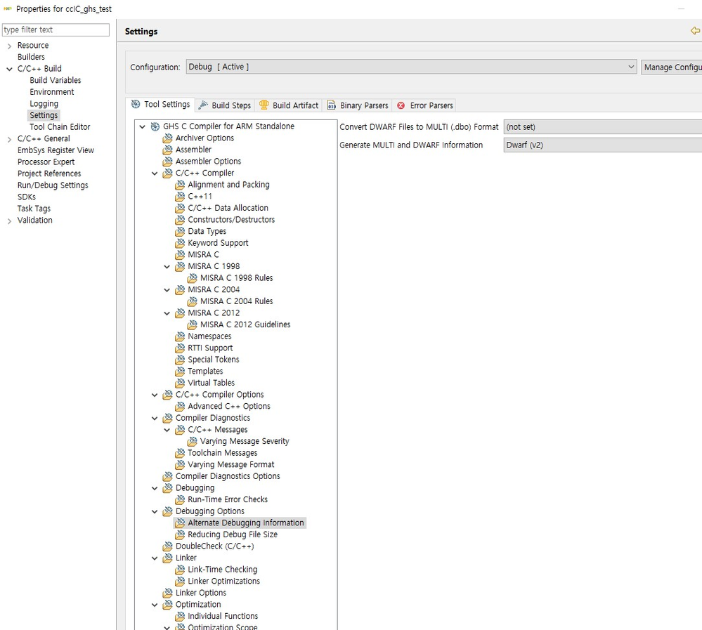

There is no Native information tab, so configured Dwarf in the Alternative information tab.
There is no ghs_test project in debug configuration even though the project finished building.
FYI, User is using S32DS for ARM 2018.R1.

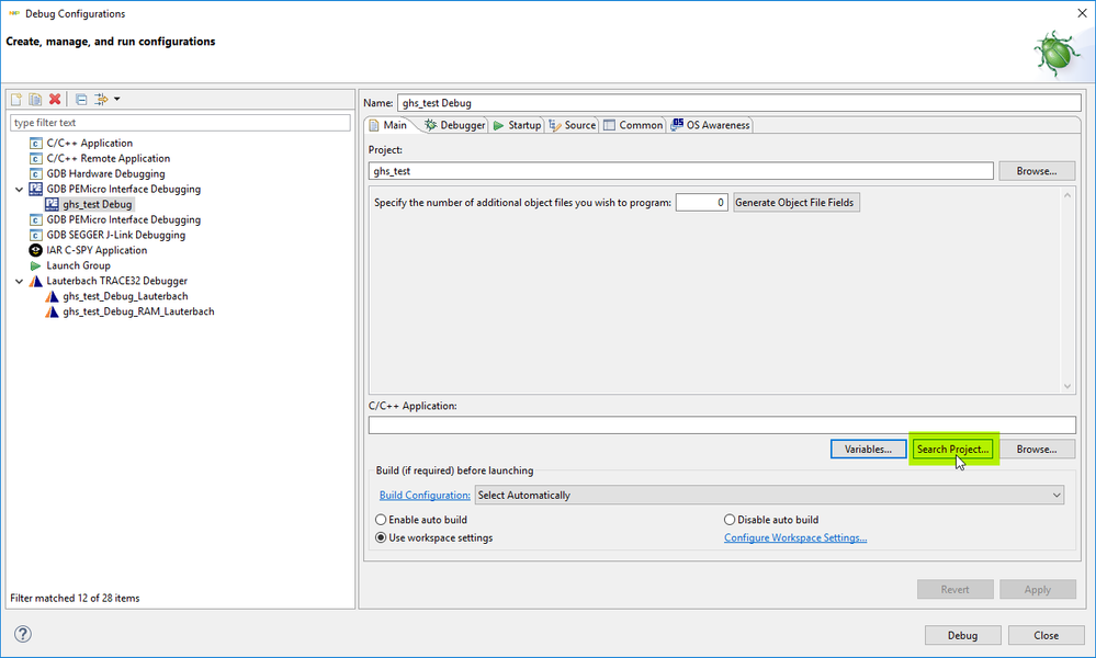

Hi Kate,
If I understand it correctly - you like add Debug Configration for PE Micro or Segger J-Link, right? By default - project with GHS compiler can be debugged only with Lauterbach.
Unfortunately - both probes (PE Micro/J-Link) doesn't fully support GHS elf format and there are some limitations (don't know which ones right now - but I'll try find it). But debugging is possible.
Open Debug Configurations -> Right click on GDB PEMicro Interface Debugging -> New:
Add elf from project:
and select device:
Hope it helps.

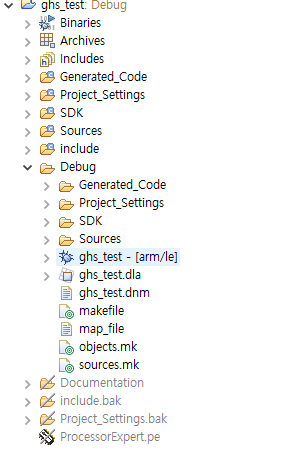

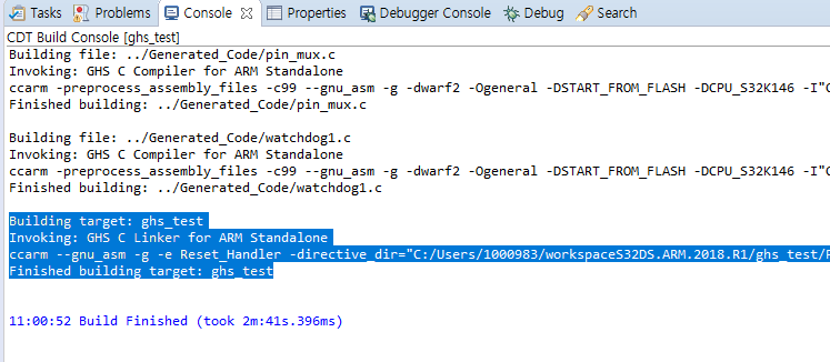

leekate-b45752
Hello Jiri,
When I build the project, elf file didn't generate as below, is it a normal symptom?
Kate Lee
4,559 Views
jiri_kral
Hi Kate,
So, you are missing build target, correct? Unfortunately I don't have GHS license. Can you please share full wide output from build console? It looks, that .elf executable just don't have .elf extension. Is in Debug folder ghs_test file without extension?
