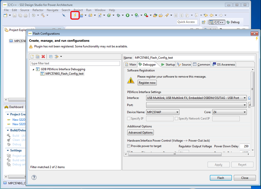

Hello Sir,
Do we have a flash programmer on S32DS PA?
My target is MPC560xB, and I would like to download elf or s19 to d-flash, where can I find the flash programmer on S32DS PA?
Also how can I dump the internal flash including C/D flash via S32DS PA?
lastly, how can I type the censorship password via S32DS PA?
Neo
2,396 Views
stanish
Hello Neo,
currently you can use a S32DS debugger configuration to program your custom .elf/.srec file into the target MCU.
See e.g.:How to download separate .elf file to microcontroller using S32 Design Studio
In coming release v1.2 there should be the flash programming support available in IDE that makes it easier.
Regarding DFLASH programming support please check this document:
https://community.nxp.com/docs/DOC-334155
Memory View does support import/export- dump of the target MCU memory.
Please check this thread - it works the same way for code/data flash:
S32DS how to properly dump RAM in debug session?
Regarding the censorship entering - I need to check this option first. I'll let you know
