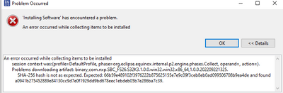

Dear Community,
I just tried the latest FS26 driver package (September 2022), FS26 1.0.0 D2209 installation in S32DS3.4. But it seems that there is problem with this installation package. Please see below for more detail:
'An error occurred while collecting items to be installed session context was:(profile=DefaultProfile, phase=org.eclipse.equinox.internal.p2.engine.phases.Collect, operand=, action=).
Problems downloading artifact: binary, com.nxp.SBC_FS26.S32K3.1.0.0.win32.win32.x86_64,1.0.0.202209221325.
SHA-256 hash is not as expected. Expected: 66b59e489102f3976222b875625155e7e9c09f3ceb8eb0ad099506708b9ea4de and found a0941b275452889e84130cc9d7e0f1929dd9bd678eec1ebdeb05b7e286ba7c39.'
It has the same behavior with the S32DS 3.5. The SHA key is wrong in the plugin.
I see that we have the .exe and the .exe is working. How can I integrate the .exe instalation inside the S32DS? I can open an example from the folder and import the files but after that the drivers from the FS26 will be needed to be imported manually in the project. The .mex file cannot import them because the drivers will not be inside the S32DS itself.

The new release package for FS26 on S32K3XX is available on NXP product list, please take it for your note:
2,721 Views
cuongnguyenphu
Hi @victor_reis ,
Sorry for this inconvenience, currently the package FS26 1.0.0 2209 is not able to install because of the bug in the release package. We're working on it to solve the problem.
You can try older version of FS26 as FS26 1.0.0 2208 CD01 or 0.9.1 instead:
