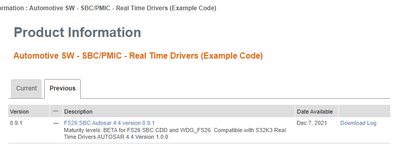

The new release package for FS26 on S32K3XX is available on NXP product list, please take it for your note:

Hi @victor_reis ,
Sorry for this inconvenience, currently the package FS26 1.0.0 2209 is not able to install because of the bug in the release package. We're working on it to solve the problem.
You can try older version of FS26 as FS26 1.0.0 2208 CD01 or 0.9.1 instead:
