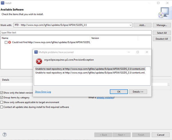

I am really stuck here.  Fresh S32DS 3.5 install, and I can't add in the SDK.

I can tell this is not a firewall issue because if I try to access that contents.xml file on my non-firewalled phone, I also get a Page Not Found from NXP web server.

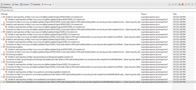

Hi @m_mishrikey
This is most likely a firewall issue. All of the sites are failing, including;
http://gnuarmeclipse.sourceforge.net
http://www.pemicro.com
http://www.lauterbach.com
The NXP site doesn't work by loading in a web browser. The error you received when trying that is expected.

I can access all the top level domains in a web browser, so I'm not sure what I should tell my IT folks about what needs to be whitelisted.

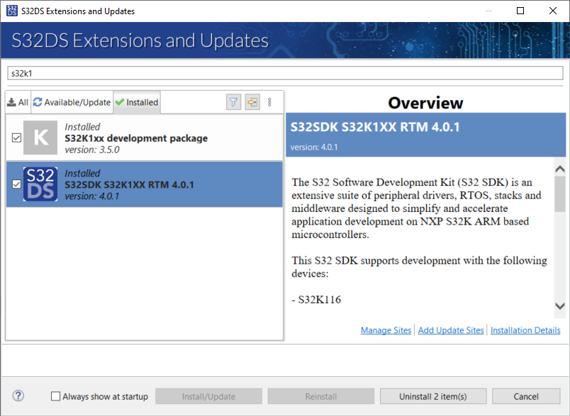

mikedoidge
Hi Matthew,
For the S32 Design Studio for S32 Platform v3.5, you are looking to install the following packages using the S32DS Extensions and Updates menu:
You will need both as the SDK depends upon the development package.

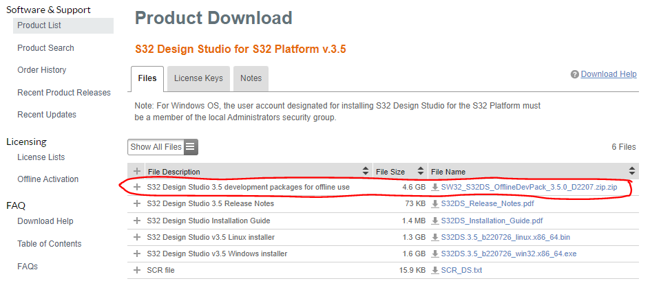

Since you are experiencing issues connecting to our update server and installing these online, I am recommending that you perform the offline install method. To do this, you will need to download the packages from our website first, then add them using the 'Add Update Sites' link (blue linked text) shown in the image above.
At this time, this time, both of these packages are only available via the large (4.6 GB) file you already referenced.
For your convenience, here is a direct link to that Product Download page:
https://nxp.flexnetoperations.com/control/frse/download?agree=Accept&element=13592207
Please note: You must first sign in and navigate all the way to the Product List page BEFORE this link will take you to the page.
One more note: The SDK package shown above is not the RTD. There isn't yet an RTD package for S32DS 3.5. The difference between the SDK and the RTD is that the RTD contains both the SDK and the MCAL drivers. The MCAL drivers are compliant with AUTOSAR 4.4. So if you don't care about AUTOSAR, you don't need the MCAL drivers and the SDK should be enough for you. If you need the MCAL drivers, then you should probably stay with S32DS 3.4 for now until the RTD package for S32K1xx family is published.
