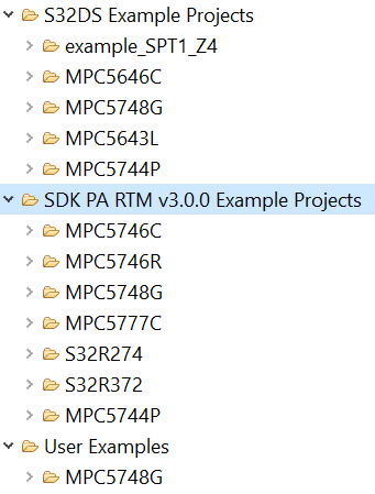

I cannot find example projects for MPC5746B MCU. I am using the latest S32DS V2.1 IDE.
Below are the list of example projects which I can see in S32DS.
Can you please help me to find the example projects for MPC5746B MCU ?
Or which one can I use in the existing list (mentioned in above screen shot) ?

there are examples only for main device from each family, not for all derivatives.
In case of MPC5746B, the 'parent' device is MPC5746C.
Lukas

As per my knowledge the 5746C is a dual core.
So, if I choose any of the projects related to 5746C, hope I don't need to change the anything related to the core configuration/startup code (Because the main core is same in 5746C and 5746B).

Hi Jayasankar,
almost all examples are single-core only, so you can use them on MPC5746B. There are only some minor differences like number of CAN modules... So, you can use the examples for evaluation.
But when you are going to create your own application, I recommend to create new project using MPC5746B, of course.
