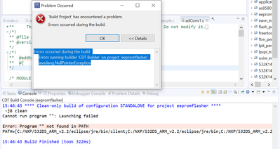

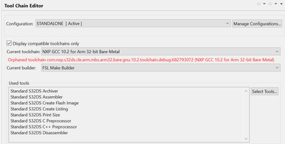

hello,
when i use s32ds compile project, there some error below, could you help for this issue ? thanks
Errors occurred during the build.
Errors running builder 'CDT Builder' on project 'eepromflasher'.
java.lang.NullPointerException
15:46:43 **** Clean-only build of configuration STANDALONE for project eepromflasher ****
-j8 clean
Cannot run program "": Launching failed
Error: Program "" not found in PATH
PATH=[C:/NXP/S32DS_ARM_v2.2/eclipse/jre/bin/client;C:/NXP/S32DS_ARM_v2.2/eclipse/jre/bin;C:/NXP/S32DS_ARM_v2.2/eclipse/jre/lib/i386;C:\Windows\system32;C:\Windows;C:\Windows\system32\Wbem;C:\Windows\System32\WindowsPowerShell\v1.0\;C:\Windows\System32\OpenSSH;C:\Program Files\Common Files\Oracle\Java\javapath;C:\Program Files (x86)\VMware\VMware Player\bin\;C:\app\oracle\base\product\19.0.0\clienthome64_1\bin;C:\app\oracle\base\product\19.0.0\clienthome32_1\bin;C:\app\oracle\base\product\19.0.0\clienthome64_1;C:\app\oracle\base\product\19.0.0\clienthome32_1;C:\ProgramData\Oracle\Java\javapath;C:\Strawberry\c\bin;C:\Strawberry\perl\site\bin;C:\Strawberry\perl\bin;C:\platform-tools;C:\Python27;C:\Program Files\WindowsPowerShell\Scripts;C:\Program Files\MATLAB\R2021b\runtime\win64;C:\Program Files\MATLAB\R2021b\bin;C:\Program Files\MATLAB\MATLAB Runtime\v99\runtime\win64;C:\Program Files\MATLAB\R2020b\bin;%JAVA_HOME%\bin;C:\Program Files\dotnet\;C:\Program Files\Microsoft VS Code\bin;C:\Program Files (x86)\IVI Foundation\VISA\WinNT\Bin\;C:\Program Files\IVI Foundation\VISA\Win64\Bin\;C:\Program Files (x86)\National Instruments\Shared\LabVIEW CLI;C:\Program Files (x86)\IVI Foundation\VISA\WinNT\Bin;C:\Users\fshi\AppData\Local\Microsoft\WindowsApps;C:\Users\fshi\AppData\Local\Programs\Microsoft VS Code\bin;C:\Users\fshi\AppData\Local\Programs\Git\cmd;C:\Program Files\CMake\bin;C:\NXP\S32DS_ARM_v2.2\eclipse]

what S32DS version are you using? It looks that you are trying import project from S32DS for ARM v2.2 into S32DS v3.5. These versions aren't compatible.
