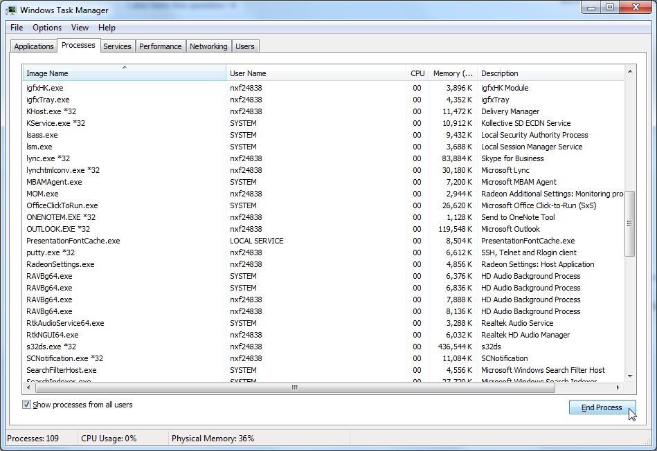

I am using S32DS to debug MPC5744P.
After I debug the project, I shutdown the S32DS. And then I want to debug, an error occurred,
see the picture:
And the volt of resetn pin of the 5744 is high.
How to deal with this problem?How to stop the another instance of pegdbserver_console.exe as I can not find it?
2,399 Views
jiri_kral
in this case start windows task manager (for example by CTRL+SHIFT+ESC keyboard shortcut), switch tab to Processes and terminate pegdbgserver_console.exe process - if it is present.
Jiri
2,399 Views
nathan_
Thank you very much! The problem has been solved.
