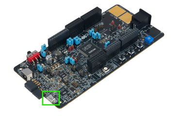

Thanks for the detailed description of your setup. I have tested with the same packages and I successfully debugged the FreeRTOS_Toggle_Led_Example_S32K344 program, I was able to perform step-by-step debugging with no problem. I a S32K3X4EVB-T172, which has a build-in debugger using the PEmicro configuration in S32DS.
From my perspective your issue is related to the Segger-Jlink plugin, I would recommend to contact them directly to know if their debugger features FreeRTOS debugging.
