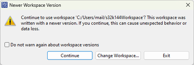

I am trying to drop back from S32 Design Studio 3.5 to 3.4 but it recognises that the workspace is for the newer version and gives three options:
If I select Change Workspace... it just keeps bringing up this dialogue box and I cannot progress without rising corrupting my workspace !

You can simply move your old workspace to let's say backup folder, then the S32DS will ask if it can create new workspace.

easiest way is create new workspace with S32DS v3.4 and import your existing project into that workspace (File -> Import -> General -> Existing Project into Workspace).

Okay, but if I hit Continue it might mess up my workspace, if I hit Change... it keeps bringing up the dialogue box and if I hit Exit, Design Studio closes - catch 22 ?!

Yes, that is what I did in the end.
