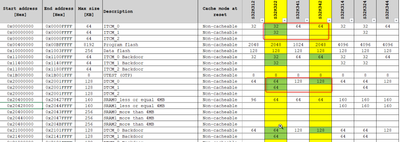

Shall we use s32k344 example driver code for s32k322 microcontroller? or Do you have driver code for s32k322 microcontroller?
Thanks in advance

1. In the Linker file, ensure that the size of ITCM and DTCM are as shown in the following code. Also, the Linker file is already provided when you create a new application project with the desired MCU.
int_itcm                : ORIGIN = 0x00000000, LENGTH = 0x00008000    /* 32K */
int_dtcm                : ORIGIN = 0x20000000, LENGTH = 0x00010000    /* 64K */
2. For S32K322 the most viable option is to generate a new project with the corresponding MCU and then copy the application source files from your pre-existing project as well as any customizations you made to the project properties.

As you know, S32K3 has many derivatives, so to reduce effort, in the most recent RTD releases we only provide examples for K344, K358, and K396. Examples of other derivatives can be created based on these existing examples. Also, as you are using RTD version 2.0.3, all S32K342 examples will work for S32K322 as long as you modify the DTCM and ITCM size in the linker script.
The S32K322 devices are supported by RTD 2.0.x, 3.0.0 and 4.0.0. You can find a list of supported derivatives in ReleaseNotes.pdf (Chapter 2.3 Supported Derivatives).

1. Can you tell me procedure to modify the linker script?
2. We are having ADC, SPI, CAN, I2C, timer and RTC driver code for S32k324 controller. Shall we use this driver code for s32k322 controller?
Note : We taken s32k344 example code as reference for configuring the above drivers.
